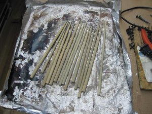

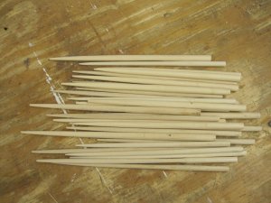

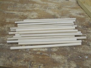

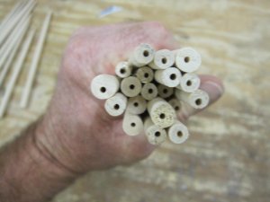

Lynn , here is what I did to make the trees . I followed the basic outline that I got off of a you-tube video . I don't remember who's video it was to give proper credit to unfortunately. I started out with 1/4 and 5/16 inch dowels and cut them to the length I wanted my tree's to be .
Then I drilled a hole in the bottom of each "trunk" for a pin to use to mount to the layout .

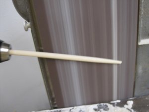

Then I shaped them . I used a cordless drill and a fixed belt sander , but you could use what ever you had available to get the shape you wanted .
This is now what my pile of trunks looked like.

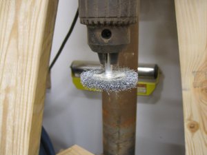

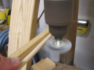

After shaping them to what I wanted , I used a small wire wheel to rough them up and put some bark texture on them.
this is what I used to put bark texture on the "trunks"

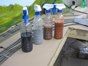

Then I put my color washes on . I colored them all at the same time .
These are the colors I used . I just kept applying until I got the color I wanted.

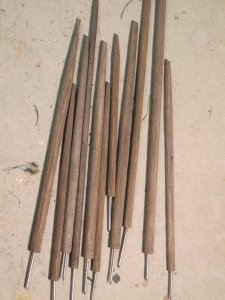

This is what I used for the anchor pins . I just cut the heads off and pushed them up inside the "trunks" .

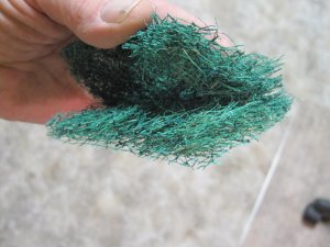

This is the material I used to make the basic branch structure . I got it from Amazon , but I was told you can also get it at Walmart .

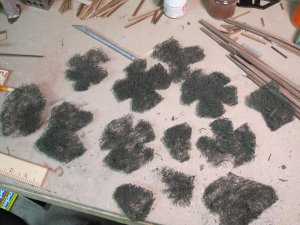

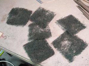

I cut the material up into about 3 inch squares . They are about an inch thick which is just to thick so I cut them in half to make them thinner.
After I cut them in half , I took and painted some of them with Krylon Camoflauge Olive and I left some of them unpainted . It kind of depends on how dark you want your finished tree to be .
After the paint is dry , cut them into random shaped pieces . I cut some clover shaped and some like stars . The only thing I found to try and avoid is to try not to leave sharp points .

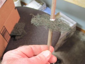

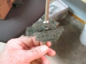

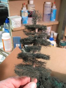

Now that all the pieces are ready , you start your assembly . I start with a bigger piece slid over the trunk to where I want then apply some white glue to hold it . Then put on a small piece and glue . Just keep that pattern up till you get to the top.Then glue a piece of the cut waste on top to finish it.
Once you get it to here , set it aside to dry while building more. Once its dry take your scissors and do any trimming that is needed . I found that most of the trimming was at the top to taper the tree . Also take the opportunity now to cut any wild strands off .

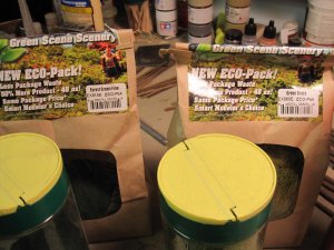

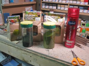

This is the material I used to put the "leaf" on .

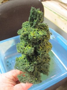

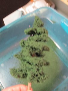

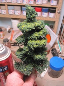

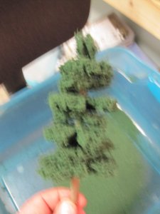

Take the hairspray and give the "tree" a good heavy coat and then over a box or some sort of catch basin apply your darkest color flock , putting it on until it wont hold any more . Once applied tap the trunk a few times over the box to catch anything that falls off . The stuff that falls off can be reloaded into the shaker to be reapplied .
Lightly put more hairspray on again but this time only on what is the top of the branches . We don't need to stick any flock under the branches this time. Then apply your lighter accent color .
And here you have it , a tree ready to plant ....
I hope this little guide will help someone with tree building . It is nice to be able to give something back to the board , I have taken so much from here and plan to take more :)

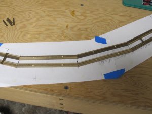

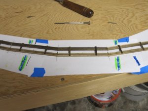

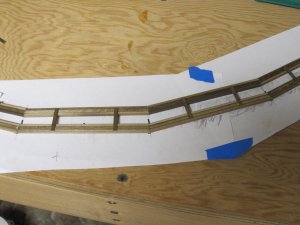

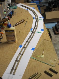

Now that I got the first trestle out of the way and learned a lot doing it I am going to start on the main one now . It is 45 inches long and will have about a 10 inch under track truss bridge in the middle so that the bents wont be improperly supported . This one wont go very fast with the holidays and all but I thought I would post photos of the progress . So here are the first ones . These are the stringers and I put some very thin cross braces to hold things better in alignment I just put small dabs of glue to hold them as I figure once the bridge is done thy will be removed but I did use stained wood , just in case .
The truss will go in between the blue and green scribbles.

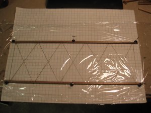

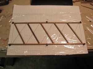

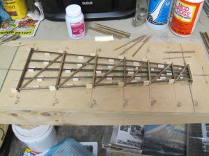

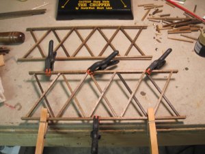

So I have a couple photos to post of the very slow progress. What my plan is , is to make a modified Howe timber truss and basically put it between the bents that go over the stream . This is what I have done so far . I made my 1-1 pattern and cut all the pieces for that step . Then I put some plastic wrap over it so the glue would not stick and pinned the top and bottom runners down , which made it very easy to apply some glue and position the cross braces .
Then I took those and rotated them and glued the 2 assemblies together .
This is the bent jig working .
