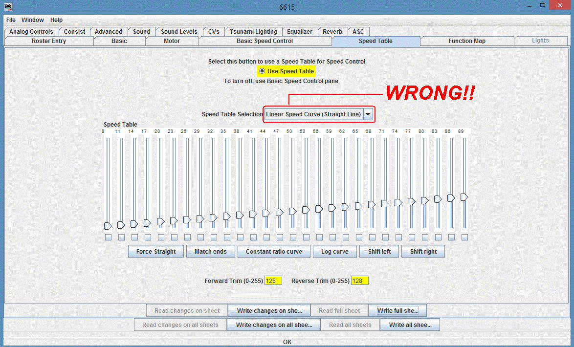

In my last post I mentioned that I was about to attempt, for the first time, to use DecoderPro for speed-matching my locos. The good news is it works great on all my non-sound models - it's true, I really can perform the actual task in less time than it takes to read the instructions. The bad news: My Tsunami-equipped Genesis geeps totally ignore any changes I make to the speed table. This is a bummer because I wanted to be able to consist a single sound unit with two or three other non-sound locos. I tried in vain to do a google search on the topic using the phrase "Tsunami speed match DecoderPro" but got no exact matches - only a gazzilion partial hits. But I'm positive I heard of somebody using DecoderPro with Tsunamies before..?
Yes. You need to enable speed tables for the decoder. There is a setting for it in decoder pro.

Terry, is this "setting" a radio button in the center of the Speed Table page? Or something under another tab that is more SoundTraxx-specific?

I remember it being a two step process. One is to uncheck the start, mid, max button, and the other is to check the use speed table button.

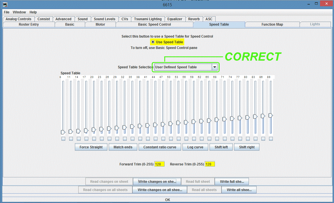

The DecoderPro-Tsunami mystery is solved: I had "Linear Curve" selected for the speed table type, rather than "User Defined".
