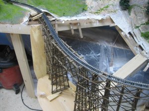

Fantastic job on the trestle. When you are ready to mount rail on it I would highly recommend the ME bridge track. You would want to keep the joining rails at each end loose so they can be joined onto the trestle track following the curve and make sure the joining rails are not short if there on a curve. I need to replace one track on one of my non trestle joining rails which is of course in the curve. Right now it has a joint only 20 ties or so down the rail and I will be changing it so it is a full 3 foot length and solder the joints to the trestle rail.
Lynn , I was worried about the joints on the bridge when I first decided to do this at this size. What I did , was when laying the track , all removable trackbed pieces were first fit and tested then the track went down . All joints were soldered well back into the permanent part of the roadbed . The only thing I opted not to do was to use bridge track . I may decide later that that was a mistake , though I hope not .

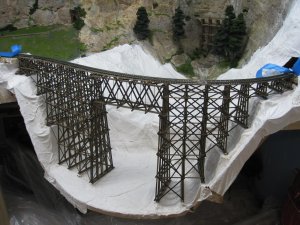

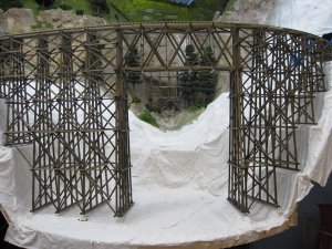

Well guys , here is the view that I had envisioned , albeit finished of course , that prompted this entire scene . Now that the bridge is in position I can build the bent foundations and then start on the landforms . I hope that all the extra eyes will find the defects , and point them out while I still have time to fix them .

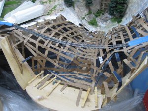

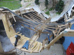

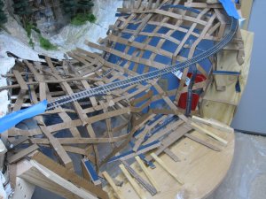

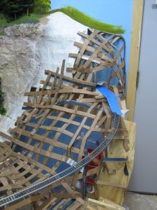

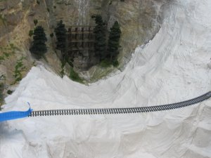

Thanks for all the encouragement guys . So I started the landforms . I installed the cardboard strips to the rough shape I wanted the terrain to follow .

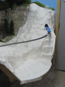

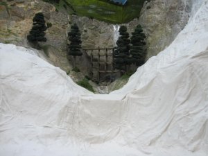

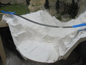

After that is was start throwing plaster coated paper towels at it . This is a very messy process so I had to make sure plastic was down first .

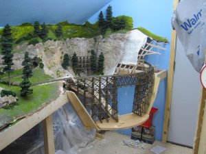

While rough , you can start to see how I envision the terrain looking like . There is a small waterfall right in the middle that will be framed by the trestle bents.
Lynn , you are right . I had never got to this point on my old layout so its is not just something new but also very enjoyable . It is really satisfying to have a vision in your mind and see how close you can come to making it .

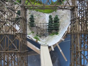

Here you go Lloyd , I was not sure it would still fit either It just took some minor scraping to go back into position . I do have a lot more filling to do on the bottom of the bents , but I need to do that also to form the streambed .
