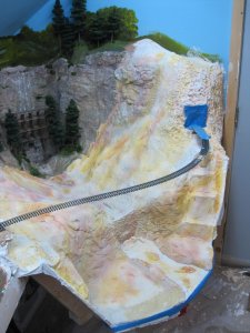

Trestle looks great. If you have some earth color paint you may have an even better vision with the white gone.

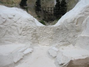

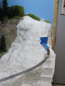

You are right Lynn , its time to get rid of the snow and bring on springtime :) I was able to do the rockwork that I think I want .
Now I will start putting some color on .
The bracing Lynn is built in to the benchwork . Right out of view to the left is support down to the floor and on the right it is fastened into the studs in the wall . The benchwork in this area is all 2x material so I feel pretty good about that. As for the fascia , I have given it very little thought actually . On the rest of the layout the bench work is all right angles , but the top cantilevers out over the benchwork in a freeform design ( again I was not thinking about fascia ) so I don't know how I would be able to put it on the rest of the layout . I had briefly entertained the thought of putting a curtain up to hide all the storage underneath the layout and may still end up doing that. I am open to any suggestions for solutions to my short sightedness on the fascia.
Jim I was basicly looking at the form in the photo and was thinking it might have been a bit fragile, didn't want to send you in the opposite direction of your scenery.

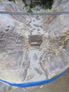

So what do you think caused the discoloration when I used hydrocal over hydrocal ? you can see it in picture #2
Sometimes its the amount of water used to mix the product that makes the color take differently...maybe a wash of A/I would help it blend a little better. I think it looks great, youve done a fantastic job so far.
Welcome to the board Charlie . I had not considered that different amounts of water would affect the way it took color.

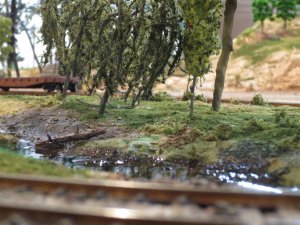

My rocks ended up looking wet and it was not on purpose. I poured envirotex in the pond and it kind of crept up the rocks a little and they have a wet appearance. You could spread out small rocks in a throw away pan and pour it over them or just try pouring it over them down the waterfall and it may adhere.

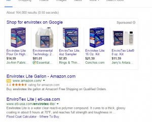

I had not thought about the envirotex David . That's what I use to pour my water also . Maybe I will try to brush some on a sample and see what turn out.
Whew ... that stuff is expensive!
OK .. How about painting the rocks with some gloss spar varnish, or that stuff they put on bar tops?
I think the 4 oz sampler covers about a square foot. It goes a pretty long way, I did all my waterways with a container costing $25 and only used 1/4 of the amount. Not very good math on my part. I will be adding a few more ponds as a result.
Sherrel , I believe that the envirotex is the stuff , or atleast one choice , for doing table tops . The spar varnish might work well also but I already have some envirotex and it does not smell near as bad a spar varnish while drying. If it does not work though I will try a sample of the varnish .

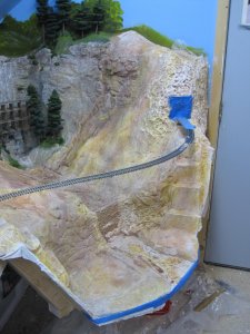

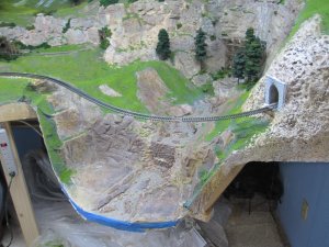

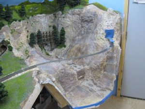

So I got some more rock coloring done
and did some streambed prep work

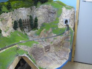

and put down the first layers of landscape
