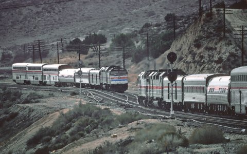

Putting together some of the pieces, I'll guess you are a passenger train fan who was still interested in passenger trains about the time of Amtrak's inception (1970)...and who was still interested when the first carset/trainsets and locomotives built specifically for Amtrak were rolled out in the late 70's. Those would be single deck intercity cars and trainsets used more east of the Mississippi and the double-deck Superliner sets seen out west.
As migalyto already said, KATO N scale Amtrak equipment should be to your liking, and I'd start there myself.
Attached photo shows a fair part of the Amtrak mess, with Superliner cars far left and single deck Amfleet plus smoothside cars.
The locomotives are EMD F40PH's which became a fleetwide standard, although originally intended mostly for the short-haul trains.
Any of that look familiar, or ring a bell?
