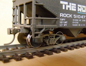

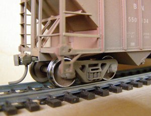

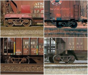

FYI: The pre-roller bearing trucks being lubed w/ grease would get coated w/ the grease including the wheel faces. So they wouldn't look "rusty". Learned this from a very "old head" modeler.

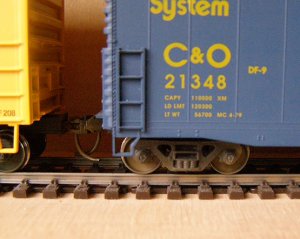

Thanks for the tip! Yes, I know that part of the wheel bearing looks more dark and oily. I just wanted to try the 88 code. I had the paint in cans brown and black.

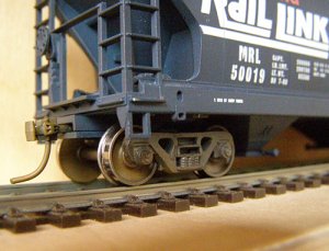

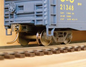

They look much better Rustam. The Rail Link car looks best because the edge of the wheels is not shiney.
Yes, Mike! I agree with you - the edge of the wheel shines a lot.

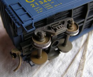

Now look - I tried again. I think what happened to keep the rust on the rim)))
When the cleaning wheel flange after the paint, it turns over again;-)

Ya but if you look at a lot of real cars the edge of the wheel rim gets shiny when going through Self Guarding Switch frogs as used in yards and hump yards so thats prototypical as well.
Here I also agree! When the car goes "downhill brake / hump", the edge of the wheel braking, while still clean.

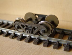

As far as the metallic wheels, I today I prefer - intermountain 88 code.

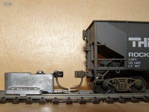

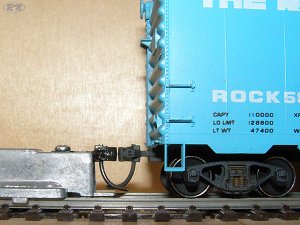

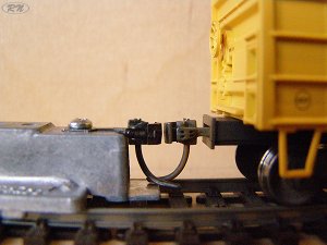

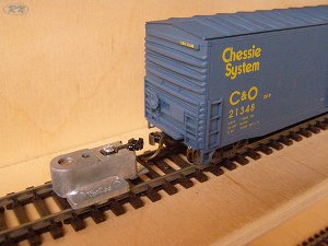

To adjust the height of the hitch I use Kadee # 205. A very good thing!
In the choice of wheels for trucks I like to "Itnermountain". There are 100 and 88 of the Code. Code 88 is certainly more realistic!
Although I have a lot of different metal wheels from different manufacturers. I think sometimes you have to choose the car under its wheels. As they say - what do I go? ;-)
Rail material I PECO code 100. With a rail shooter and nothing flies!Kadee_205_01.jpgKadee_205_02.jpgKadee_205_03.jpgKadee_205_04.jpg

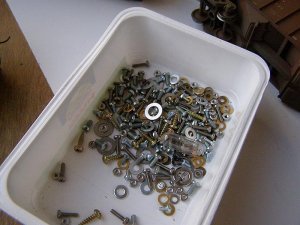

By the way! To adjust the height I use these screws and washers that I bought at different stores "home handyman."
Although I explain to you the friends you already know how to do it. I'm just looking for these debts washers)))))2237.jpg
