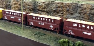

Working on my second round of homemade hopper loads. This time I was lucky enough to have scrap pink foam. My last one was styrofoam, which worked, but this works better.

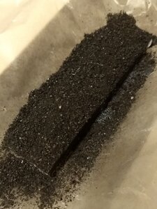

The black stuff is a homemade coal load, made with cinders from Milwaukee Road #261 I collected and screened.

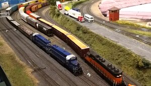

A nice topic with some very good ideas. James on page 1 asked for Woodchip hopper pictures. Matt Smith is an online buddy who made this car for his Railroad, the Alabama Georgia and Gulf and sent one to me. I still owe him one of mine after a year.

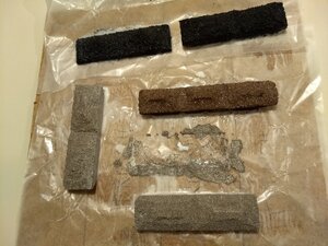

Normally I'm a fan of live loads like this coal train loaded with walnut shells I dyed black,
But the gates on this ballast hopper don't work (yet) so it got a carved chunk of blue foam with some Woodland Scenics ballast glued to it. It looks ok, it is the first load I've ever made this way.
