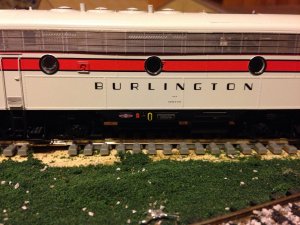

For locomotive without a visible cab number, I write the address on the bottom of the fuel tank with a black permanent marker. If it's a steam engine, it goes on the bottom of the tender

Or you could get some decals and add the number to the engine in a appropriate location.

The engines I am referring to have numbers on them already, in the location they are meant to be. They are too small to be seen.

I guess I do not understand. Numbers on the bottom on the tender could not be seen either.
They can be seen by picking up the locomotive and tender, and turning it over. With microscopic numbers, they cannot be seen at all.
