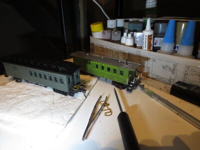

I purchased the "combine" version of this model, and worked it over a little,
The clerestory did not have glass so I added acetate. I removed the plastic handrails and made some from wire also added a piece of real chain, also painted the trucks, faded down the body and added some decals:
The plastic handrails came off easy. The smaller combine in back is an older version, that one got replaced by this one

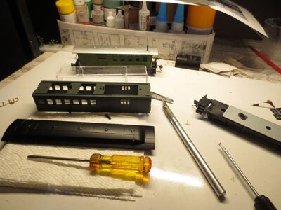

Here is how it looked taken apart. I think it was only two screws?

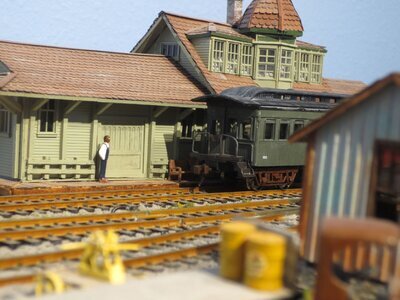

Here she is with the new railing, this car is on my layout all the time, I will have to get a better picture
The car tracks well and does not derail.

Thanks! ...I took it apart to put in the clerestory "glass" (plastic). Also, to paint and weather without worry of getting the slop on the windows.

Here is a better photo,
I had a lot of difficulty getting the handrails right, finally used a round object to wrap it around for the rounded part, also used the railing I took off as a template.
I cannot read the small decal, but I thought it looked cool to have a little message by the door. It came off a sheet of caboose decals.
