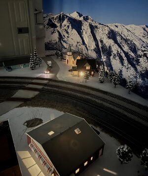

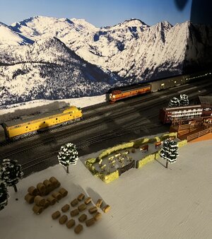

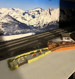

The problem: when misting and applying the glue mixture described above the ballast clumps up as you can see in the following pictures. The blue circle highlights the Scenics Express ballast that has been misted. The red circle highlights the scenics express ballast where the glue has been applied. Just to clarify, the track closest to the camera is meant to be a more beaten-up and worn down siding where the ballast hides a lot of the sleepers, so it's not like this issue has completely ruined it... however... I'm still really frustrated with the unrealistic clumping. I've also included a pic of the ballasting shaker.

While I could get away with a semi-light misting of my solution on Woodland Scenics ballast, I wasn't wetting the Scenic Express ballast nearly enough (thanks for the suggestion, @Mixed Freight , @santafewillie , and @Selector ). I was able to get a much better result by thoroughly soaking the ballast. It kind of made my skin crawl to wet it so much that it dragged some of the painstakingly placed ballast out of position, but the end result is very smooth and realistic, as you can see below. Any small clumps that remained at the end I sanded down to a finer gravel, which added a lot of realism by slightly varying the size of the ballast. After it was done drying I tested it to see if it would hold in place and it was hard as a rock. FWIW I don't think I could soak Woodland Scenics ballast as much as I soaked the Scenic Express, due to the fact that Woodland Scenics's ballast is made out of crushed walnut shells (or something like that), and Scenic Express with crushed stone (basically sand), and too much liquid drags the crushed walnut shells way too far out of position.
