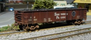

My LHS had a carboard box with several of these in it priced at 7.99. It looks like they were "used", as they were already assembled.
I bought 6 of them. Does anyone know who makes them?

We'd need to see the bottoms for some clues. Is the gon metal or plastic?

I think it's a Model Die Casting (MDC) kit. I bought a bunch in the 1980s and carved off all the details and replaced them. It likely has a cast metal underframe.

Thanks Iron Horse. Here is one more. It has a lot of detail added on. Another Athrean?
Unfortunately, I can get too rough when weathering, and before I new it, I had knocked off all four stirrups and the brake wheel on this one. The stirrups I can replace easily enough, but I've been all through my parts boxes and cannot locate an extra brake wheel.
Here is one of the gons I did. Sorry about the grainy shots, I am experimenting with an LED trouble light for photos, I don't like the results. Too washed out.
One thing about the MDC gons... The ones I bought had no molded detail inside the walls. No rivets or seams. Just a complete blank. So all mine have loads. Do your MDC gons have inside detail? Did they ever improve on that?
