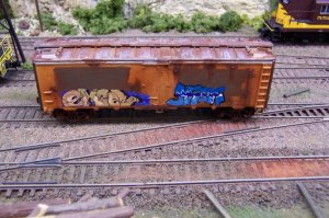

I use KD under the track uncoupling magnets and a couple of above track uncouplers. I have areas that are too far from the edge of the layout to use my RIX uncoupling tools and even close to the edge I have under the track uncouplers. The locations of the under track units are marked with some foliage material from Walthers that is mounted in the middle of the uncoupler. I add the uncoupler "markers' as I ballast the track.
Yes, the rolling stocks coupler trip pins must be in good alignment to operate properly with the uncouplers. I check all my couplers to be sure they are withing the proper height. I mounted a uncoupler magnet at the end of my work bench's DCC programming track to check my rolling stock's coupler operation.

In the attached photo, in the lower left, there is an uncoupling magnet under the spilled iron ore and is marked by the discarded railroad ties. Later today, I will mark the location with foliage material and I will post another photo of the completed area.
