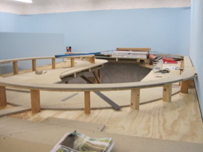

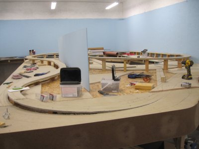

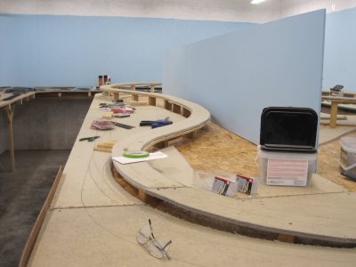

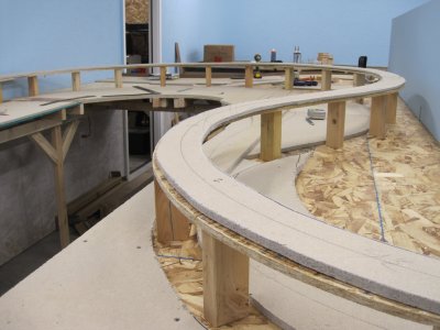

the bottom layer of OSB is for support/structural and the top layer is homasote for ease and holding power of track spikes . Actually...

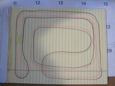

Todd , the situation I have would be you bottom crossover drawing and where the rails diverge going into the loop portion is where I...

Horseman , I am not sure I follow what you are asking/saying . As I said my grasp of wiring is not that great . The way it is right now...

my crossover is built up - 4 turnouts and a cross . My interpretation of lead in a piece of flex on each side of the turnout . The...

you will have to excuse the crudeness of the drawing but it make the idea . Black and pink are the rails and green is the crossover...

Paul , you are correct , there would have to be some lead in to the crossover on both tracks . Tim , if I draw my plan out without the...
