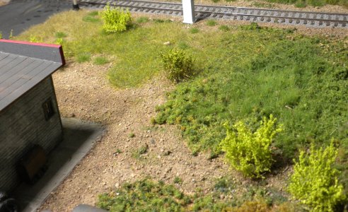

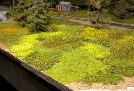

Exactly! Textural Variance
YES!!! Excellent. Seeing what you see and not what you thought you saw. I love the rear of the first picture. The darker shade plus what looks like of rusty red near the building, hardly noticeable, but makes the scene.
The second scene of more earth. Showing that earth is there before any grass. Then the 'fifty shades of green. Well done.
