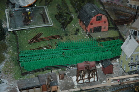

well, summers almost gone but for the high temps in Texas! Anyway, looking at the layout its showing a rather large dust issue wherever there is trees and grass, buildings track, well, just all over! so its time to break out the air compressor and vacuum and clean it all up. so that really is so much fun. Next year i think i willl cover it with a plastic tarp to keep the dust off. After painting the house i know that somewhere i have one of those clear plastic tarps floating around here somewhere. And whats next? well its a bit late in the summer but i think its time to grow some corn. plow the corn field up and plant lots of corn. that way they can feed the cows and with the sweet corn themself's at home. I already have ran some trains around the main so i know i fixed that bad turnout. a couple of shots below. hope you all had a safe and fun summer wherever you be! Smoke

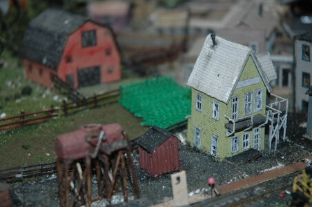

I had some family business and a pluming issue in the kitchen so i hadn't done anything to the layout, but i did get a bit done this evening. first rows are planted. there is three sets of rows to plant the crop. Shot below, Smoke
