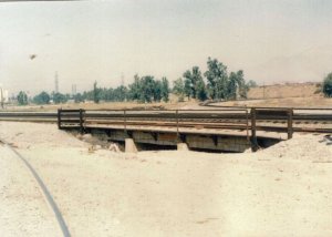

In the mean time, I'm thinking of how to design a low profile bridge to install.
This type of bridge is very common on former SP lines:
