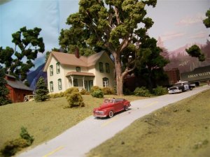

Tree armatures
Living in the west, sagebrush is easily found make outstanding trees, right down to the bark. If there isn't any available, perhaps you may have a friend who can get you some.

When doing scenery, look at all the bushes and shrubs around your own local as often there are dead twigs that either fall of or can be broken off which make nice armatures for trees or as Montanan above said branches of Sage Brush, Oak and others make great trees for for your layout and with either the Oak or Sagebrush the natural bark can't be beat.
