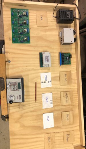

With the control draw build complete, next the actual layout of the components i have so far (see attach 1)
Mounted the BLD168's and the 2 DS64's (the remaining 4 x DS64's will be replaced with DS74's)

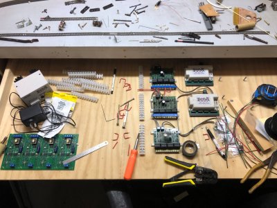

Did some Loconet cables and started wiring the BLD168's
And as you will see in attach 2 what a mess you can get into

Still working on the control draw, I surprised myself with the amount of wiring it has taken!!
Found some wiring design faults (me DOH) with the BLD168's and I removed the PSX4 as it was redundant because of the PM74.
This then led me to need another PM74 to accommodate 2 additional power districts.
Received the additional DS74's so was able to finish wiring to the terminal blocks, so pretty much the draw is finished except for the new PM74.

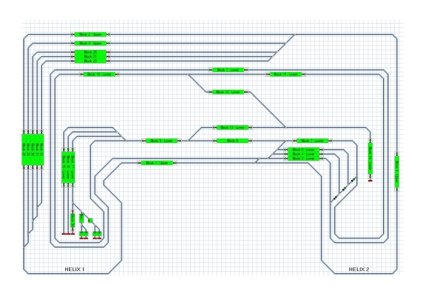

I have attached the Track Power and Block Detection drawing - Let me know if you see an error
