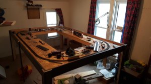

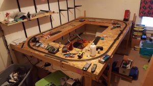

Several years ago, I caught the bug and built the basic table for a layout and pretty much ended up with a single large oval laid on a 9 X 6 framework consisting of 18" X 6 modules screwed together, at which point I began accumulating engines and rolling stock at an alarming rate with no real plan, most of what I bought was on a whim, bring it home, run it around the track a few times and box it back up and never actually progressed on the railroad. Train room became a catch all, the layout became a table for that purpose, other interests, running a business etc and several years later, fresh from a summer vacation out west to Yellowstone and back, I found myself looking at the door to the train room, and a couple weeks before Christmas, opened it. Several large tubs and bags to the garbage, and everything organized again, a ton of stuff put on CraigsList, and a trip to the hobby store tomorrow night and I am ready to turn this into a proper layout, a completely fictitious line based solely on how I want to play with my trains.
This is what I'm starting with:
This is the first phase of the plan and the main line, the "yard" in the lower right hand corner is elevated at 4", there will be two ramps at 4% and an 18" bridge, should have more than enough NS sectional track to do it three times over:

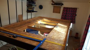

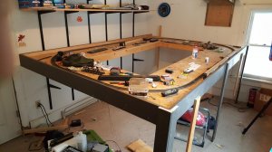

The original deck was built by screwing 2' X 6' sections together consisting of 1" X 4" and 3/8" OSB, which of course resulted in a fairly flimsy set up that needed lots of piers to level it up on the extremely out of whack floor. I had a stack of 1" X 6" and 1" X 4" painted brown for another project that's on hold till spring, so I embezzled it for this project. Screwed and glued the 1" X 6" around the edge straightening everything out in the process, made it significantly more solid as you can imagine. I had the original setting low, I know there was a reason at the time, but I'm taking the opportunity to be kind to my back and knees and raising it, top is at 42". I took a picture, I'm on coffee break, my goal is to have it ready to strip the old track before I have to go to a function.

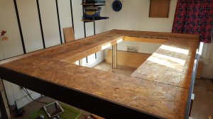

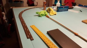

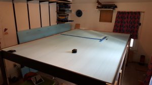

Got the legs on and it now sit's where it will stay permanently, temporarily leveled, I'll cut extensions to screw to the legs, and a band brace still needs installed. I have 2' or more of clearance on all sides. Now I need to clean the room thoroughly and get ready to start ripping up the old track and get foam down.One leg needed over 2" of shimming to get things fairly level, 100 year old house, well settled, and on it's last owner...
Applying KISS principals, I nixed adding an extension to the table, mainly because it's already huge relative to the room, and it made things less complicated overall. Since I can now access all 4 sides easily, I'll eliminate the opening in the center altogether, gain real estate for other things and still keep the basic concept of where I'm going intact.

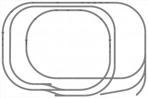

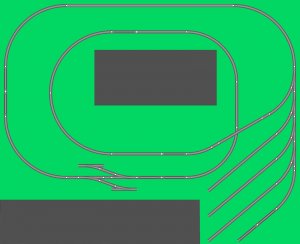

In the track plan in post #9, there are two unnecessary turnouts at the lower left. Just have the tracks curve in toward the turnouts.
Steve S
The turnouts in that one serve a purpose not illustrated, one goes to an isolated programming track, the other would go to a small yard. But I've scrapped that one, took too long to get my order, had time to stare and change my mind ")

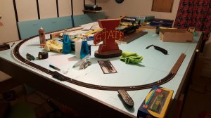

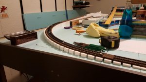

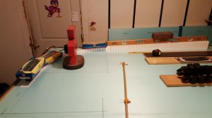

The radius on the incline is 24", Atlas #837. The whole layout will most likely be sectional since I have a boat load on hand and I plan on doing power feeds every 3'. As you can see, the track is a bit off from the bed, which is a bit off from the incline, combination of shadows and being anxious to get going. But it's close enough for government work, once the layout is fleshed out and ballast laid etc, you'll never see it and who cares if you do, it's about fun, not perfection.
