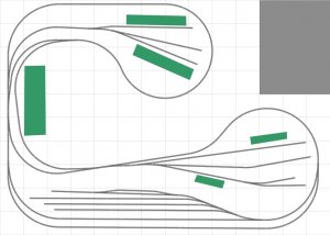

I have been playing around in Anyrail.
I tried to use some of the ideas from here.
I am thinking I will start with a flat track since the elevations are giving problems.
Below is what I have so far. Industries are still completely open to change.
I think I need to figure out what I want there and buy some buildings then lay the track around them as needed.
The inside of the layout is a walk through. I like that better than a duck under.
Is that dark gray area a place you can walk through to get "into" your layout?
Dale,
That looks a heck of a lot more doable.
As you have completely begun again, can I ask why you didn't double track the outside of the layout then have your sidings and yards and industrial areas running off of them? Just looking at potential bottle necks.
Definitely a bit simpler. Are you going to be able to reach to the back of the yard at the bottom of the plan?
Looks as though each square represents 12" X 12", if that is the case, then he should be able to reach all parts of the layout.
New plan looks great to me now. Good job man, you will like that layout.
You have two reversing sections now. Are you using DCC? I suggest getting the Tony's Trains PSX-AR auto reversing units. I have them and they work great. Don't get the Digitrax reversers, my opinion is they suck.
I've marked the reversing sections with a red mark where you will need to gap the rails. The tracks inside those sections will need to be connected to the autoreversing unit to power all those tracks.

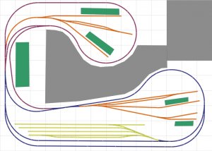

I did some designing in Anyrail today.
I tried to clean up the industries a little and my first attempt at figuring out my loops.
I think I have 2 loops. The red at the top and the blue at the bottom.
The squares are 12".
Let me know what you think and thank you all for the replies.
Looking really good nice job man. I was studying it more and I missed something I told you earlier for the reversing section loops.
The red track on the left that goes next to that industry. That is not a reverse loop so that should be part of the regular standard track. Neither red or blue. Make regular tracks black or something.
I marked red where you need to gap the rails. You will need two auto-reversing units. Get these here:
http://www.tonystrains.com/products/dccspecialties.htm
(Learn More Here)
