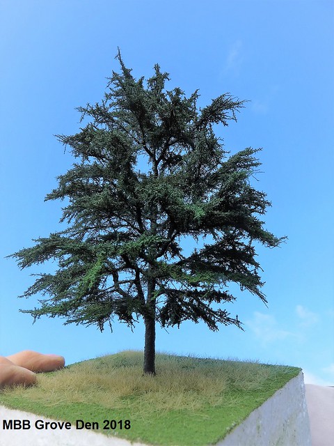

Gave it a shot last night. Lousy picture, but the tree came out pretty good. :)

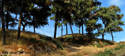

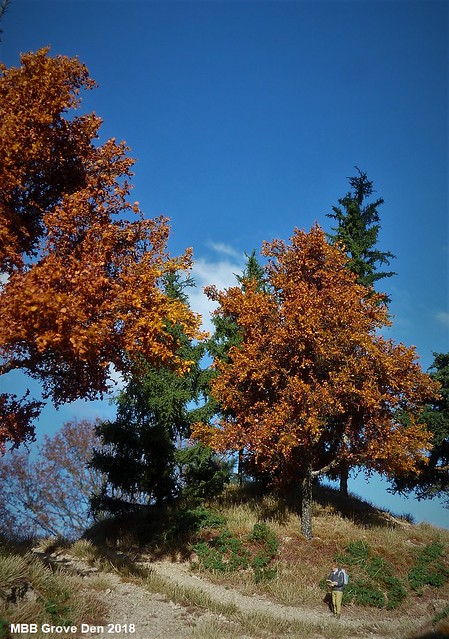

Still busy with modelling trees and landscape:
detail of the diorama 2 inch. x 2 inch.
on a hot sunny summerday:

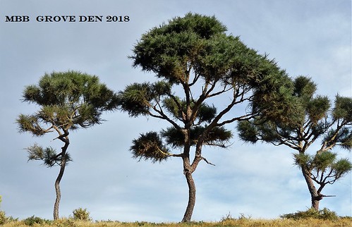

Latest efforts;
an old oaktree in winter scale H0 and about 12 inches
the same in summer:
and the trunk close up;
