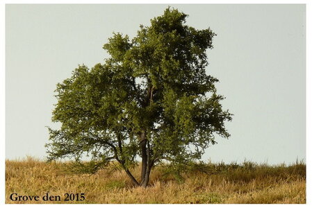

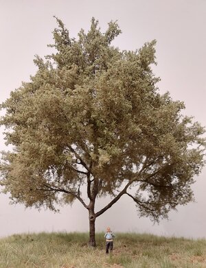

747flier:
I had wondered about how you were doing the multitude of branches.
I try to keep it "simple"....the small twigs/brances are actualy fibres of halloweenwigs! So no "individual"wires.
The tall shrub in post #622 has only 3 wires the rest are long- 1 inch max. fibres of a wig.....and of course some smaller fibres like 4 or 2 mm ones before adding the "leaves".

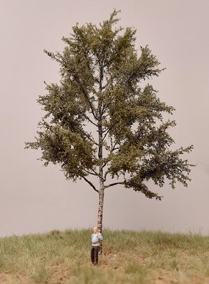

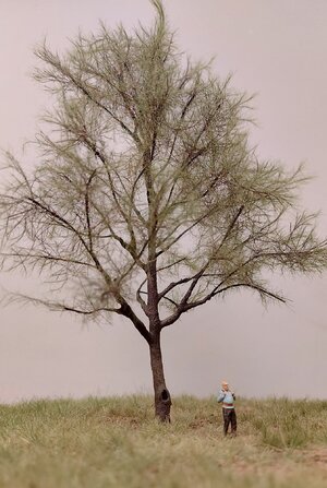

You apply the wig fibers through the static grass applicator or apply by hand? I am modeling the WP&YR running fro SE Alaska over the mountains to Yukon so mostly Spruce, Cedar and birch/aspen. Thanks for the help!
747flier: You apply the wig fibers through the static grass applicator or apply by hand?

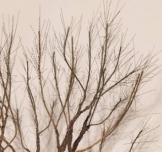

Well both ...if the type of tree or shrub is "asking" for applying by hand I mostly add these fibres on the tree/shrub upside down... gently strike with some fibres over the top/ends of the wires. These fibres are mostly longer than 1 inch.
When using the applicator I recommend only fibres cut max 1/2 to 3/4 inch an inch!

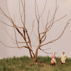

The branches on the trunk of the aspen are all just one wire........the twigs are 3 different lengths of fibres. Starting with the longest and ending with the 2 mm. I always spray the twigs/branches/ fibres a darker colour as the leaves I add to the tree.
Jos

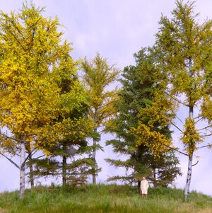

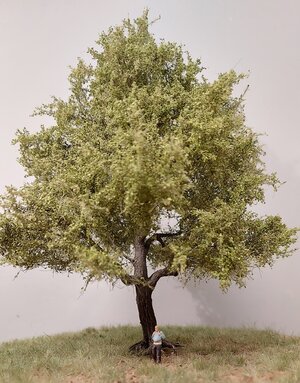

Latest " work"... plus 2 trees " under construction"= only fibres: 15- 20 mm , 12mm and finaly the 4 mm...

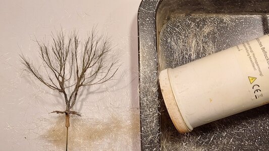

The wig( fibres) branches are far to thin for drying in/at the right angle(!!) on the trunk! That is why I use the 0,4 mm floristic wires for the "main"branches....
in this case/tree I used no wig fibres but 12 mm fibres first( 1 minute)
added 4 mm fibres...( also 1 minute...)
and the end result after an extra minute:
May be in Z scale????

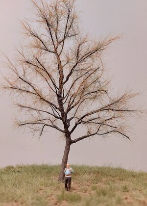

A static device is not a must to make conifers( fir, spruce etc.)
When addi ng fibers by using a strainer!! Not by hand) , for example 12 mm ones a hairblower can blow all the fibres pointing down.
The " main" direction of the twigs , using the hairblower, is easily done this way!
Only adding som smaller/ shorters fibres like 4 or 2 mm and ending with fine turf as immitation of the short needles.
Btw I glue the fibres and turf with spray glue.
