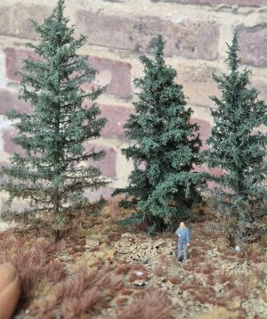

This time a smaller one :
a "blue spruce "for H0 scale medium high and for N scale high!
Needles are made of 0.5 mm fibres.
The Preiserman is about 21 mm. Tree itself= 157 mm/ 6 inches
Same type of tree and frame building.. only this time I used sieved fine turf weeds over the "branches" as imm. needles.
lIt ooks more"chunky"?? than the 0.5 mm fibres.
