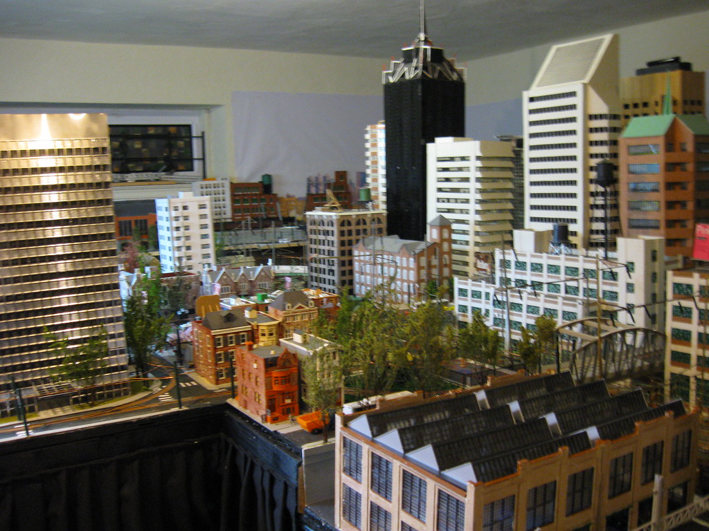

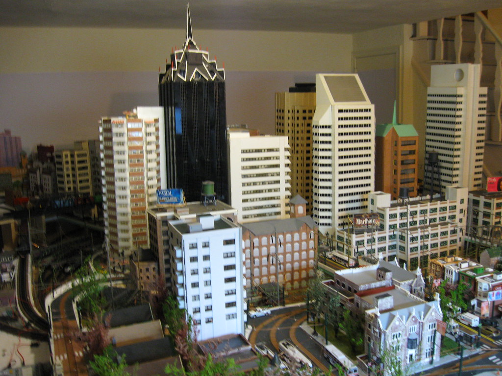

I have built a total of 14 modern highrises in my HO scale city from materials that you can find in Homedepot and various Crafts/Art Stores
I have about 6 more High Rises and a Station Head house to Build and the Layout will be about 85 percent finished. This layout is 2 two layouts in one. one for trolleys and another for heavy traction
ac_catenary
Railroad Architect
Modern High rise buildings
The buildings are made of clear and colored acrylic and lexan plastic as a building core. Styrene sheets/strips are then glued on as required. Windows are made from plastic matrix sheets and window shades are made of tape. I have not lighted the buildings yet but because of the construction it should be easy. I use a CAD program to design each building before it is built and print out exact elevations which I use as templates when building. If I had a laser cutter I would be in business.
