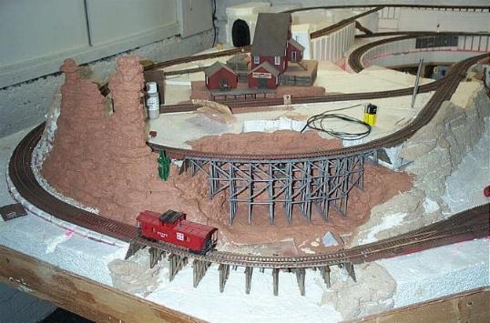

In my case, it was so my pink plains and pink mountains didn't stand out so clearly in photographs. That much coverage can make a quart of paint a good investment.
Painting the basic layout surface with a paint color that matches the predominant color of the area you're modeling is a good idea. As Jeff said, it covers up the pink (or blue) foam color and helps when you miss a few spots with ground cover later. If you're modeling you local area, just take in a baggie of dirt and get the best match on the color chart. If it's another part of the country, look at as many photos as you can find and match it as best you can. Make sure you only get latex as oil based paints will rapidly give you a whole bunch of canyons and gullies you don't want. :)
