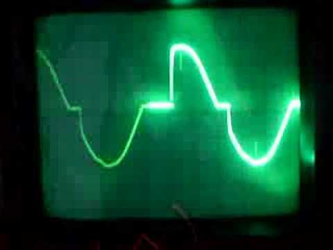

Last, if that's an older CW-80, you need to replace it. They put out a stepped wave instead of a smooth sine wave which will eventually damage the electronics. Looks like this instead of a clean sine wave. It's a matter of when, not if. You may be able to have Lionel answer if it's a newer one where they cleaned up the output, or an older one.
Picture from a CW-80 model G
Gak, that is a horrible looking excuse for a sine wave. An AC transformer isn't that hard to get right what are they doing!
