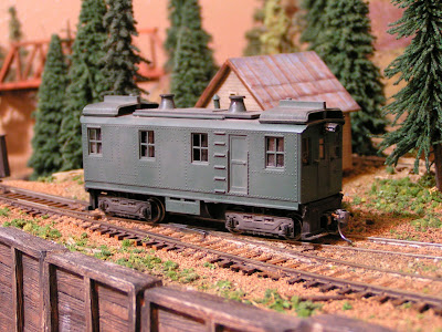

I see the one you have in the photo looks like it is the one version of the shell that they used for the track cleaner model . I had a few of those but never liked the track cleaner idea and you can build them either way. For a time all they had available was that version.
I always looked at the box cover and they had one that must have been a special one because the roof mounted radiators look nothing like the model nor do the exhaust stacks . I made my exhaust stacks out of brass tubing and used the next size brass tube to fit as a ring on top the added screen mesh and to me they look much better than the stock stacks . I'll need to take a photo because it's difficult to explain. The one I still have is the shell just like yours where the headlamps must be glued on rather than the cast on ones on the other shell that has no front or rear door and no step under the headlamps but instead two smaller steps on each side of the door. I could never decide on which shell I liked better and just can't recall what the ones I painted C&NW were I think they were all the same like yours and later I had to go drive to MDC in southern Calif to buy about 5 shells that I used to make two long units splicing two shells together and one I have here that is still the stock shell with the cast on headlamps and no doors on the ends and larger end windows without the four panes . I do know one of the frames and drives came from a climax but I never liked the way that thing looked , I got all of mine way back in the early 70's. All I ever saw back then were the track cleaner shells and perhaps that's all they had back then. They didn't even offer an un-dec model that I ever saw. I think it was right around the mid 80's that I got the shells from MDC right when they were changing the RS3 drive away form the old Athearn drive they used to use . They had a show case with the old RS3 frame modified with brass bolsters and new trucks that looked like the ones P2K came out with it was their proto-type for the new frame and then they moved to Arizona right after that.

Here are a few photo's of my MDC Box Cab
I know they are not so good like others here produce . I don't have that great of a camera .
The top photo shows the shell and the different stacks I made and the brass bell and brass vent .
The lower photo shows part of what I did to the drive . I also used NWSL nickle wheels . I am sorry the photo's are not clear. No matter what I try since the flash is on the very left of the camera I cannot seem to get great photo's it's a cannon power shot A-10 an old model and I had a cheaper fuji and it worked so much better. I have to read the manual again I must be doing something wrong . I have not used this camera much since 2004 for ebay . It has the close up setting which I use and other settings that I can't recall what they are. It even has a zoom lens but still the cheaper Fuji was much better and much easier just slide the lens cover away and shoot and everything came out wonderfull .
