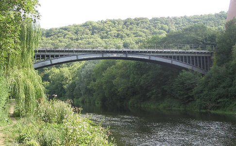

Think I can model the bridge below as an entrance point, think it can work?

Looks like a good connection to stable track, not a noticeable gap…. Been considering the lift out or the gate, thinking gate is my option…. Thanks for the pics, does give me some ideas should I do the bridge lift out idea
