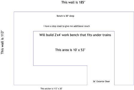

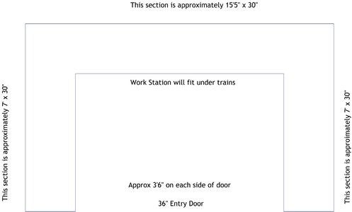

First of all, I own "N Scale".
I haven't ordered it but, I have the pad ready for the building. It will be 10' x 16' with a 36" exterior door w/windows in door. I am not sure I am going to have any other windows. A regular double hung will interfere with benchwork. I am going to have plenty of LED shop lights for lighting.....that could be up for discussion.
I am going to post a couple of pictures of possible benchwork configuration. One is a U shaped 9'5" x 15'5" x 9'5" The second is more of G shape. I want maximize my wall space.
I will build a workstation on casters that will fit under the trains. I am thinking 46"-48" high for benchwork. It is going to be 30"'s deep. I have a step stool that should give me the extra reach necessary. I am concerned about the radius of the curves.
I am open to suggestions/criticism. I would like to order the building Thursday.

My benchwork in a "U" shape configuration is 42" tall and 24" across in most areas. I do have 34" along one wall that was added. Which curves are you worried about. I easily have 28" curves in HO on my roughly 9' X 10' layout. But I do have lift-outs across the open end of the "U". Looks like nice space in either configuration.
The radius at the ends of the U, or wherever the trains make the “turn-around”. I have never had space like this.
In N scale, you need to decide what radius will suit your running style and needs. Is this to be a closed loop, single or double main? Will it be end-to-end with no turning capability? Then, build benchwork to suit.
If I were in N scale, I would want curves on the main to be not less than 15", but those are considered 'broad' curves. Not really, but that's what the literature seems to insist is so. In my HO world, anything less than 33" is too small, and most of mine are between 36" and 46". I have an around-the-room arrangement, so I can have broad curves at each end of my 9X19' room. In N, that would be between 16.5 and 23".
