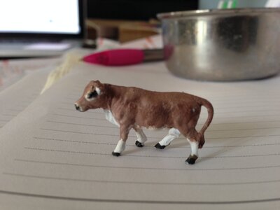

peco model so cheap to buy but appalling paint job, you can update black and white,I can show that too, but here I changed colour as well as the colour shows off the ripples on the skin
appalling as bought
I chose the palest colour that would appear on the body and covered the lot
even this pale colour improves the look
the breed I chose has a darker body so again this looks better
I liked the improvement so much I went darker still
then I painted the nose and eye area a creamy white,then with a finer brush added a dark brown black for the nose and eyes,and deepened the hooves
as I paint I often make mistakes, no issues I wait for it to dry go back paint the before and then repaint,or just touch up with the previous colour if I just added too much of the last colour,
I did cut off some of the horns as they did not look good in my opinion for the breed I wanted,but could have suited a different breed
later - not shown here - I added sone dirty water where I cleaned my brushes and swiped under the body it dried too thin and I repeated but better too little than too much, this then offered up subtle shadows that are usually seen. My own painting is not fine I tend to be fast and sloppy but you can see the vast improvement
i am a 20 effort / 80 improvement person it does not need to be super detailed that takes too much effort, and the more you put together the more it works when photographed
