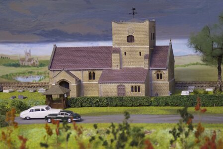

I have a set of pictures NOT done me and I have lost who did them, but they are so nice I will add then for reference
the modeller looks like he used horse hair for the canopy, then fine green foam base for the leaves, the copper is self evident and it has a modelling medium worked into it and a grey trunk,and grey is as prevalent as brown,when I saw this I was like oh yes great reference so enjoy,

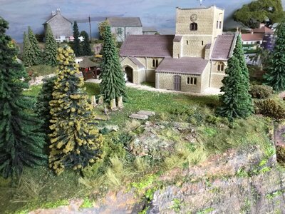

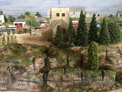

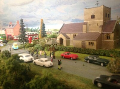

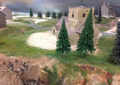

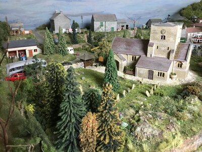

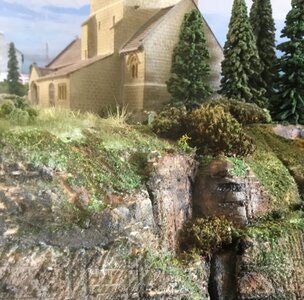

Improving bought in model trees is quick and well worth the effort. These were super cheap probably because the colour was awful some green paint then some hair spray and green ‘grass’ wood or foam,I think you could avoid the re spray and go direct to hair spray and foam
tree to left the recoloured and textured bought ione to the right homemade plastic bet for canopy then foam green and then autumnal coloured bitch tree seed
Different colour can be different seasons different species you can see the early untouched then the improved then the overall area better coloured each step improving as time allows and reference pictures, I personally like the yellow ones looks like when they are in flower
