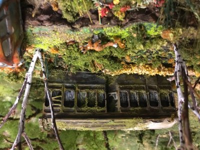

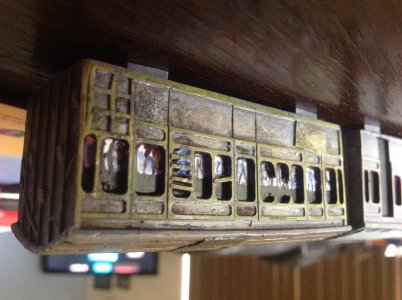

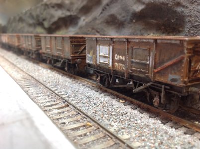

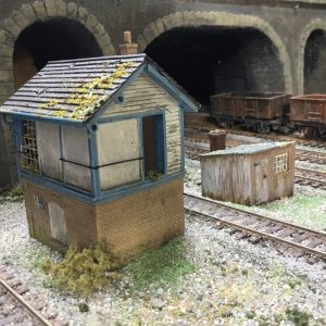

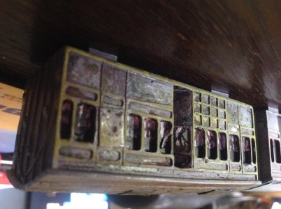

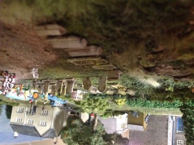

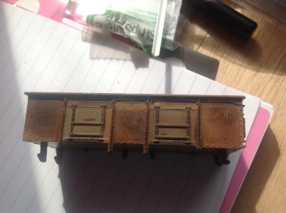

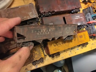

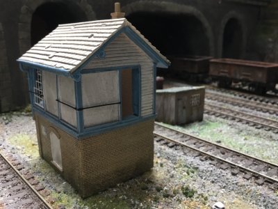

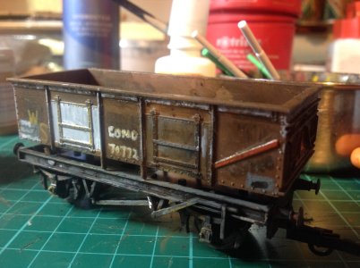

Subtle,moi? I wanted to show the signalbox, but it is not rolling stock, but there is rolling stock in the background, so a quick rerun,
weathered rolling stock ta dah!
I used those brushes on the signal box, and on the rolling stock, but much was kids paint brushes cheap and cheerful, although you might need to pluck off loose bits of brush!
And yes it is true I tend to be a bit ott, TLOC can do a lovely light finish, perfect for items that have not been running forever, completely removing that plastic toy finish. My kit tends to have taken heavy wear. His work much more often prototypical. And as he said on an another thread much of his work is as per instructions for customers. I just love teasing him. his work is gorgeous.

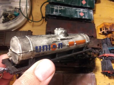

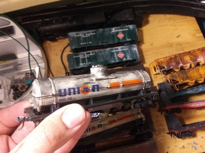

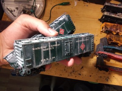

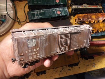

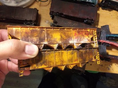

A little embarrased to post these since wow they photographed terribly. Patch out WIP. You can see the decal technique improving a bit as we go down the line. The individual numbers and letters are so hard to keep aligned though, even the lightest touch moves them. I can only stand to do about 10 letters at a time so progress has been slow. Freelanced but based on a bunch of ex-CR cars. Still need a few more decals, powdered and painted. Any tips for this besides "get the reporting marks custom printed?"
Decal work for me was always an adventure
I have settled on applying a gloss coat to the area the decals are going and let it dry and cure 48 hours. I know that’s a long wait but I now get better results than the old over night wait time. I use Micro Solve and Micro Set per the instructions. Lining up decals I thought was magic, what it is having enough solvent applied to adjust them and then lightly touch a bath/toilet tissue to a corner of the solvent to wick away the excess solvent. Then lightly pat dry.
I use a sharp scissor to cut as much film off as possible. I use a stainless steel pick to position but a wooden tooth pick will easily substitute. I use as above toilet paper sheets and occasionally a needle if I’m having issues straightening out the numbers and letters. Most of all, have patience which I have very little of but it really does help to be slow and methodical
After I’m satisfied a matte clear coat, let dry then weathering
Your picture progression though shows great improvement

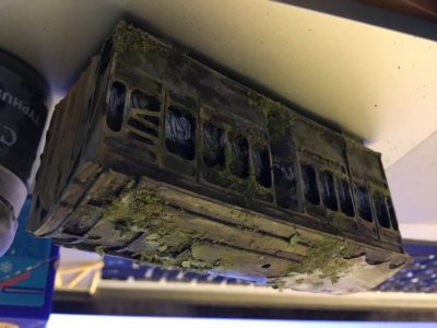

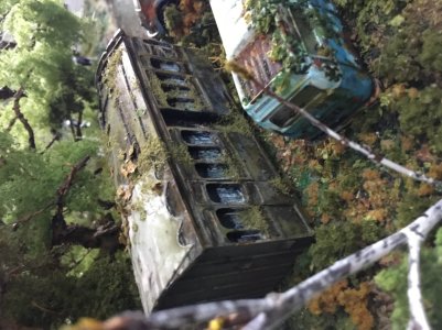

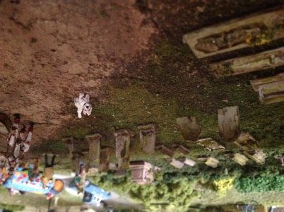

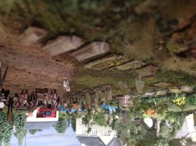

TLOC sorry no wagons, but I weathered a gravestone or two GRINS doggone those dawgies is upside down again…..runs…..ducks….oooh ducks! Yes no better not… ….nag hi am already in the dodahs (is this not where this nonsense all started…pokes tongue) .lwelllllll I have more thumbnails ducks birds geese….ohh an a weathered coach, you only have rolling stock…this is um a broken down resin coach….but but I weathered it….l
Oh and ducks (more ducks) as here’s an incoming empty weathering paint pot…….cackles madly (come on it is Halloween month……oooh now there’s a theme I could warm to…..clicks heels…no red shoes…..and heads for modelling room…l

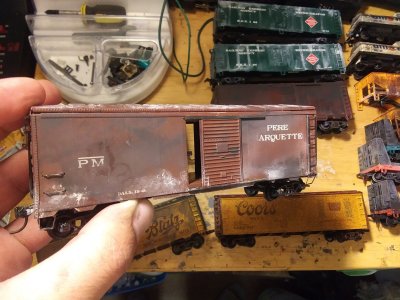

Yeah I'm learning less is more with solvent, in fact this morning I was having issues with the micro set evaporating before I got the decal where I wanted it, so I probably swung too far in the less direction. I have been using Q-tips instead of TP, but even pressing them directly down often moves the decal slightly. I should try TP, its probably more absorbent. I adjust them with my pointed tweezers, but they occasionally tear the decal (my sheet of Fusion COTs panels seem particularly delicate, but the Fusion numbers I can absolutely manhandle).
Asking on FB they said to not clear over the lower decal layers, just do it all at once, and that's seemed to work ok. The positioning is the issue, not the adhesion.

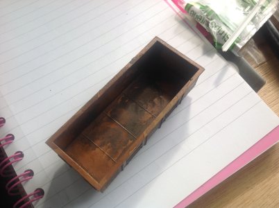

Finished all the numbers finally and starting on the weights and such. The lettering is so small I can hardly even make out what I'm cutting on the sheet. Other than the top one in the picture, I don't hate how its turning out.

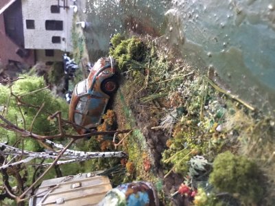

Weathered rolling stock…..there is a lot of interpretation here….taps lips with finger…
Reference I assume they used the first for their resin model - Hornby

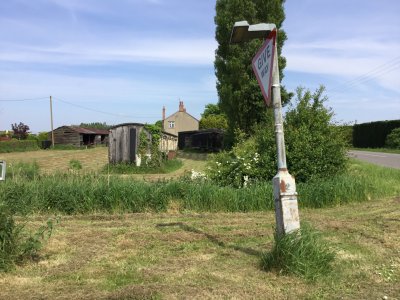

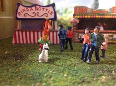

This are occasionally seen in gardens or fields, slowly getting worse for wear
And weathering of said ‘rolling stock’ the reference matter has no wheels either!

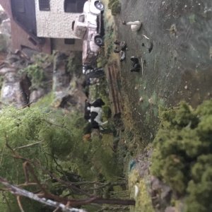

No please for plastic for windows or glue so I painted the sky line and bushes
May not be typical of the thread, but hard to argue I am actually off topic….winks
FYI still on Halloween, going to go suggest it in the coffee shop..scoots off in case of flying pots of paint..
Edit….rats I fogot my photos are drunken fall over tikes…..fyi I am sober as a judge just in a frivolous mood :P

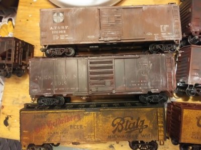

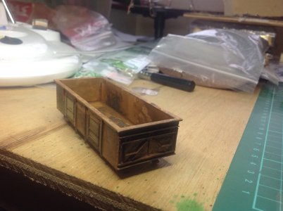

When I started masking some of my Wisconsin Interstate diesels last week I had a Walther's Mainline 60’ yellow high cube that I never had time to get to. Since I mainly was concentrating on the diesels I wasn’t thinking about pictures. But over in Tom’s ((CambriaArea51) great Weathering Engines a Continuous Thread it was in the background of a unit I was fading and taking pictures of the process. I received a text yesterday asking why I wasn’t posting the yellow TBOX
Well here is a better picture
The roof is rusted and needs some touch ups. The trucks, wheels, front and rear panels are weathered as are the couplers. The body sides have a white/thinner fade with just a drop of yellow added to it. There is a slight grime wash applied and some rust added. Don’t worry JAZZA I will pool the dirt and rust along the sill of the car. I decided after the initial washes to add graffiti and hopefully this weekend I will get a couple on the sides. The finish weathering will happen a day or so after the graffiti cures. I will take pictures from here out
