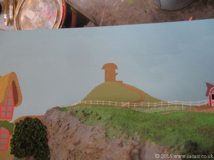

Based on the picture I was copying, the beginnings of the second farm building was started.

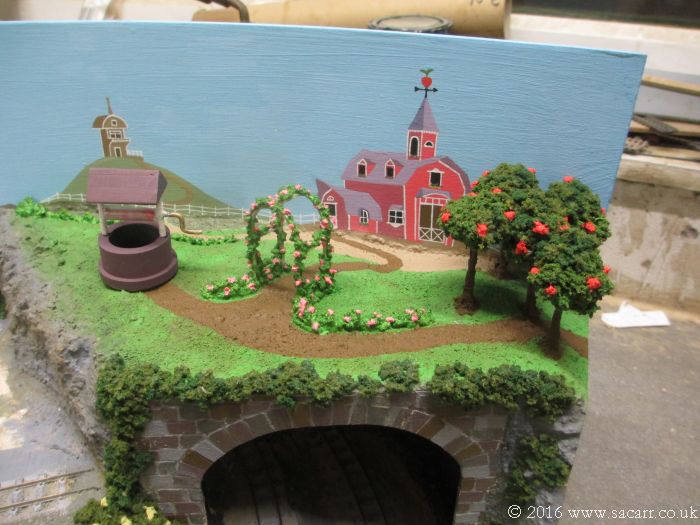

Five apple trees were added to the field in front of the farm, with their trunks blended into the ground with a paint/PVA glue mix, with a little fine sawdust mixed in.
Also based on the picture I'm working from is this rose bush archway on the path leading to the farm. Some square section brass tube was heated, formed into the arch and soldered. It was given a coat of white enamel paint and is seen here drying.
Another detail on the picture is a well. This is the start of my well. The base is 1/32 inch ply, while the main part of the well is turned modelling resin.
Some further gel pen detail was applied to the large backscene house.
The farm building is complete now.

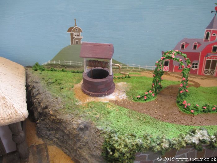

Here's the well, heading towards completion. The well needs thread adding and some detail painting of the stone work, then that can be glued down. The rose arch is now glued in place, and waiting for the roses to be added. A path has been painted to the farm.
A little more work this evening. The rose arch was covered in foliage, and after force drying it a little, the roses bloomed!
The apple trees have also borne fruit.

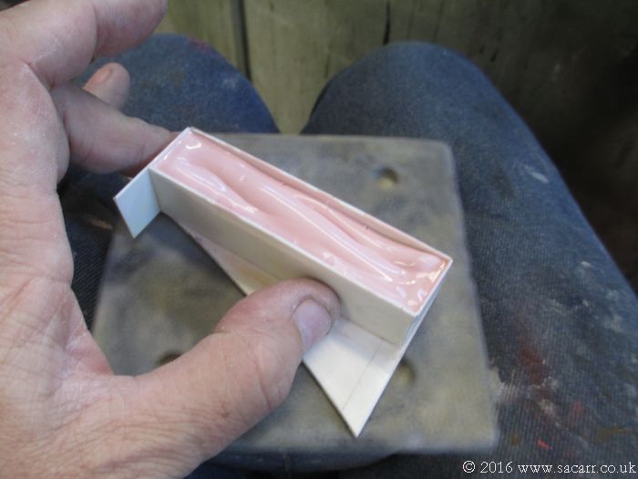

After some fine surface sanding, the frog was boxed up along with some non-rail accessories, ready for the silicone rubber.
Once the silicone was mixed and poured, I used a palm sized orbital sander to vibrate each mould to help expel any trapped air.

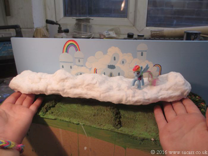

Once the moulds were done and left to cure, I turned my attention to 'Cloudsdale', the home of 'Rainbow Dash'. The screen capture of Cloudsdale from the TV was a tall thin building in the clouds. This didn't suit the space I had, so I reworked the image on the computer, making it much wider. As before, the image was transferred in pencil first.
There was lots of peering through the magnifying glass for this, as there were lots of small curved lines to follow with the brush, and the white paint not being particularly dense, required three coats to cover the blue sky.
With the artwork almost done, 'Rainbow Dash' visited to see how things were getting on. The rainbows had a white base coat painted with the colours added with gel pens.
The last painting for the evening was some detail work on the buildings and some trees and hedges on the backscene below the cloud.
This morning, the backscene paint was sanded away along the base of the Cloudsdale painting, and the cotton wool cloud epoxied on. A few more small painted clouds were added to the left side above the cotton cloud.

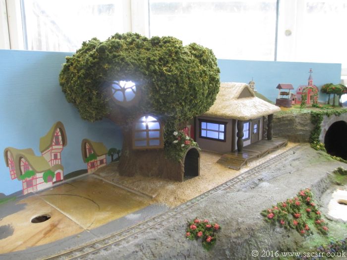

The Station and Oak Tree Library were glue down, and sand used to blend in the bases.
The LED's were also connected up to the wiring harness already made on the bottom of the layout.

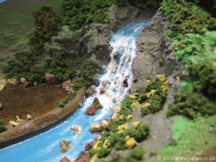

A mix of PVA glue and a light weight wood filler were mixed to make the white water on the waterfall. After it dried, it was varnished again.

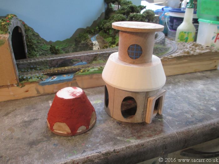

The last job done for now was sanding both the cone shaped sections on the boutique and using car body filler on the top cone. This was sanded smooth and some fine surface filler added after that. It is being left to harden overnight.
