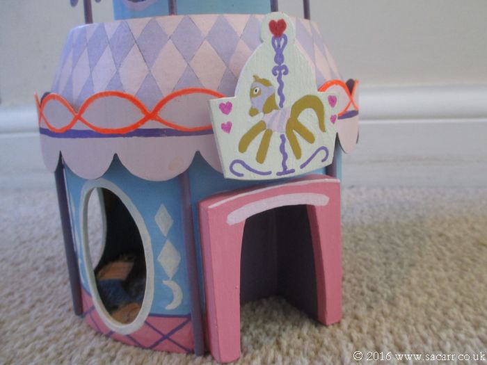

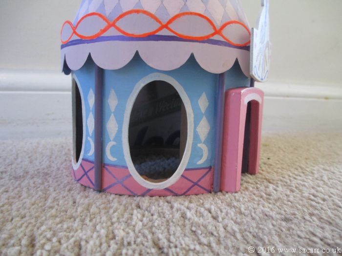

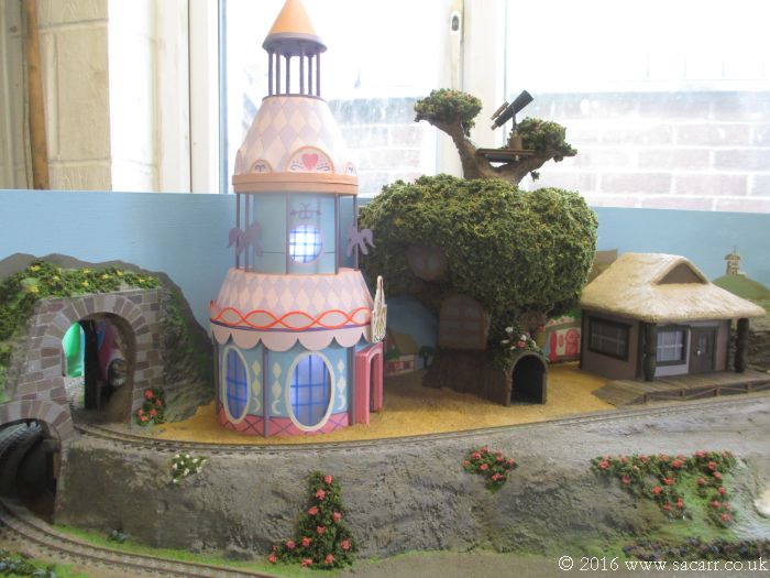

Here's the boutique in place in Ponyville. There's only a few more things to do before it can be glued down and the ground completed around it.

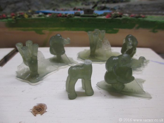

After a day and a half to cure, the silicone mould of the pony was opened and I began to cast some test ponies. Rather than pure resin, I mixed in some fibre glass milled fibres to hopefully strengthen the mix. These will be cleaned up, assembled ( probably with a metal pin in the neck to strengthen the glue joint ), and then have some alterations.

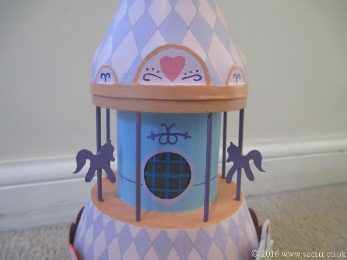

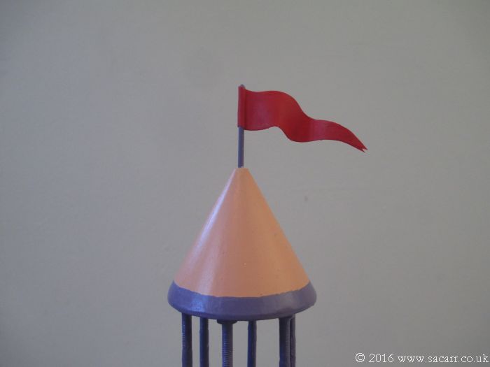

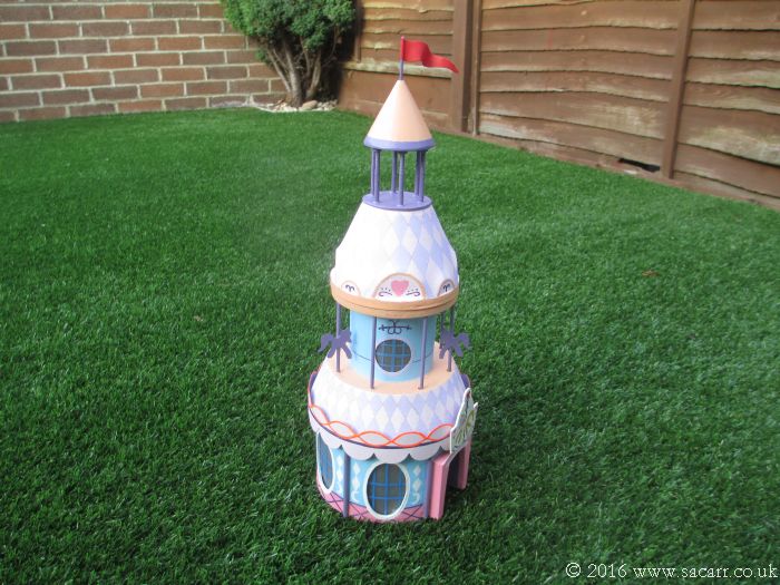

The boutique is virtually complete now, except for some small touch ups and then a matt coat. Today saw some of the finishing touches done. The flag on the top....
Detail painting around the windows....

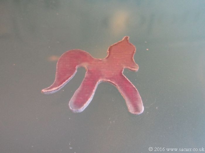

The pony outlines were made from 0.5mm GRP sheet. I printed the pony outline and used double sided tape to attach it to the back of one piece of GRP. Then a second piece of GRP was taped onto the back of the print out.
As it is translucent, I could see the pony shape and was able to use a small dentists diamond drill bit to grind the pony outline out of the sheet. They were cleaned up with needle files then separated. The two ponies were then dunked in some cellulose thinners to remove the glue from the double sided tape, cleaned up and epoxied in place and painted.

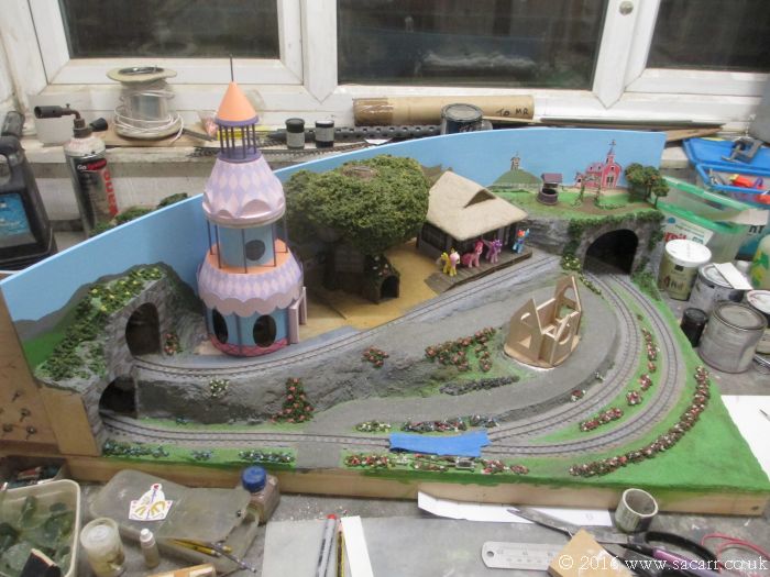

The boutique looks like it dominates the scene, but it is balanced up once the top of the oak tree is fitted.

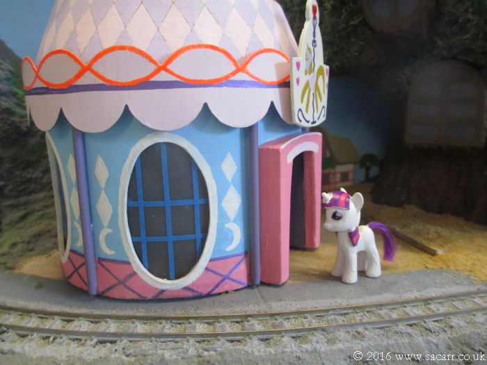

Rarity, who isn't quite finished yet, approves of her home.
After a matt coat, the boutique was glued down, wired up and sand added around the base. The sand was glued down in the usual way, but force dried with a hair dryer so I could get on with painting.
The grass around all the buildings was painted, along with the road to the station and between the boutique and library.

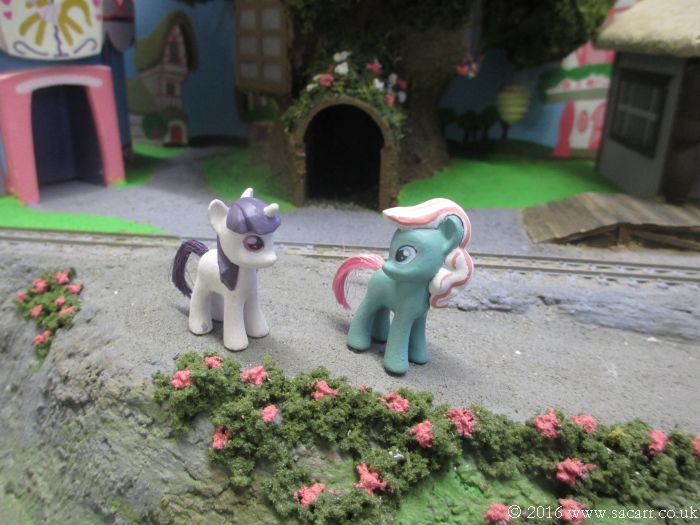

Rarity and Minty had their painting finished, and Muffin was also painted today.

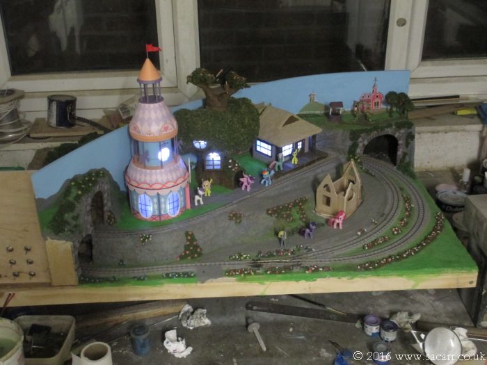

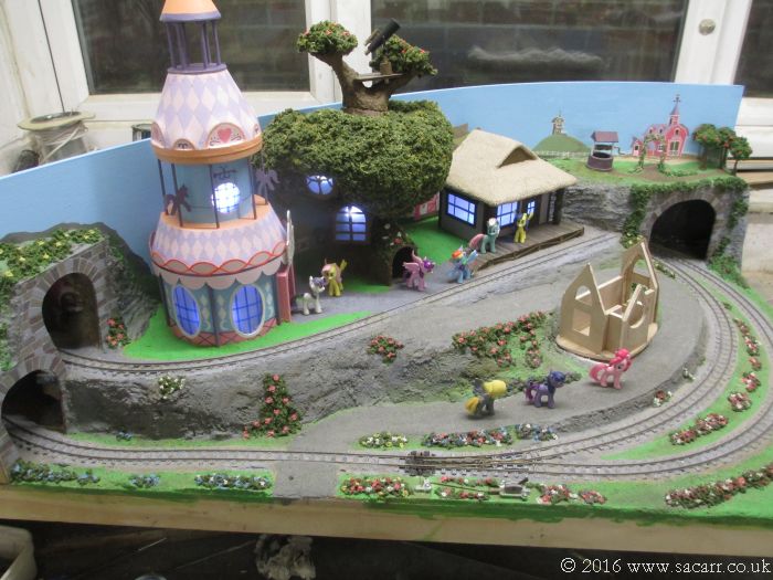

As dusk falls over Ponyville, the lights come on and the ponies chat about the adventures the next day. For several ponies, that will involve several matt varnish top coats to protect the paint from wear. I may have a look at working on some resin ponies. My wife and daughter are away for the weekend, so there's no interruptions.

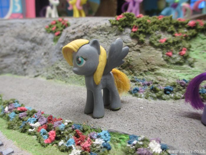

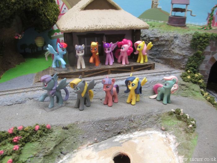

Today has been centred on a pony painting. To start with, here's the group photo so far!
Following on from yesterday's work, the four ponies were matt coated and additional ponies were painted. I painted a fast drying two part matt coat after painting the bodies, to protect that during handling while painting the other details. When all the details were done, they received further matt coats.

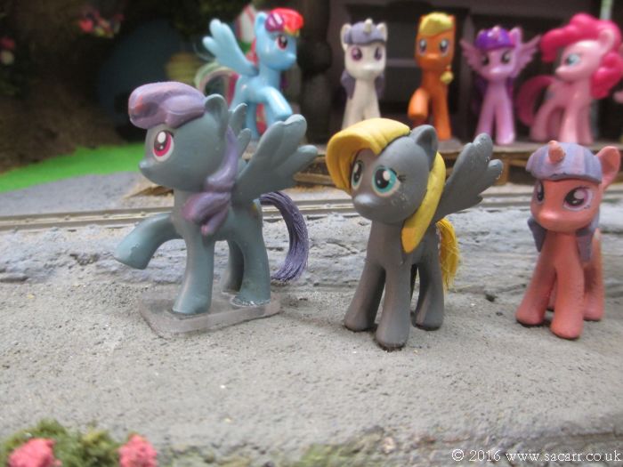

So, here's "Open Skies" and "Muffin".

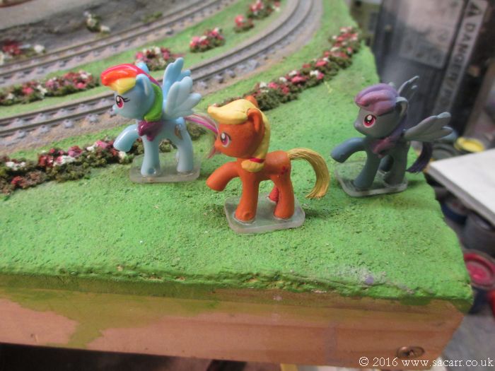

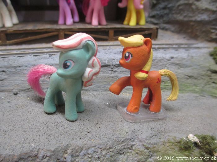

"Applejack" and "Open Skies" both began as a "Rainbow Dash", so all three had one foot off the ground, and so didn't stand up very well. As a result I made clear acrylic bases for these three ponies, pegged up through the base and into the ponies legs for strength at the joint.

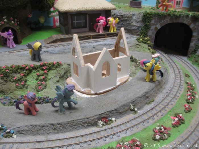

I also added further 1/32 ply skins to the cottage ready to inset the windows, and gave it a first coat of white.

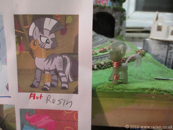

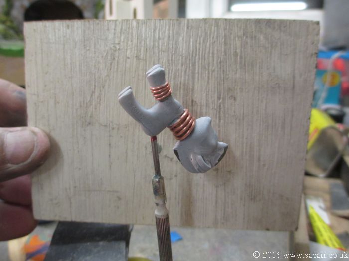

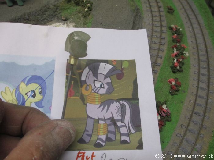

Here's the start of the first resin pony, which started life as a bought "Pinkie Pie", and after moulding a resin copy, is being converted to "Zecora"
All the ponies have had their tails shortened as they were far too long and stopped the ponies standing up properly, so the offcuts went to make Zecora's tail.

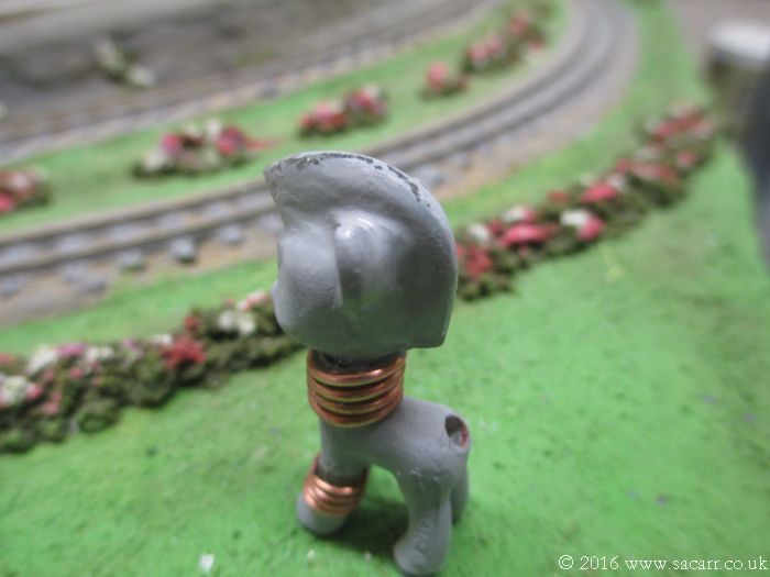

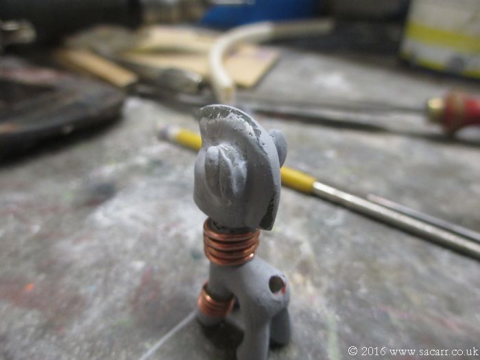

The head was pinned onto the body with a 2mm steel rod, cynaoed in place, with a brass tube support around the outside, prior to drilling for the pin. Copper wire was used for the bracelets and necklaces.

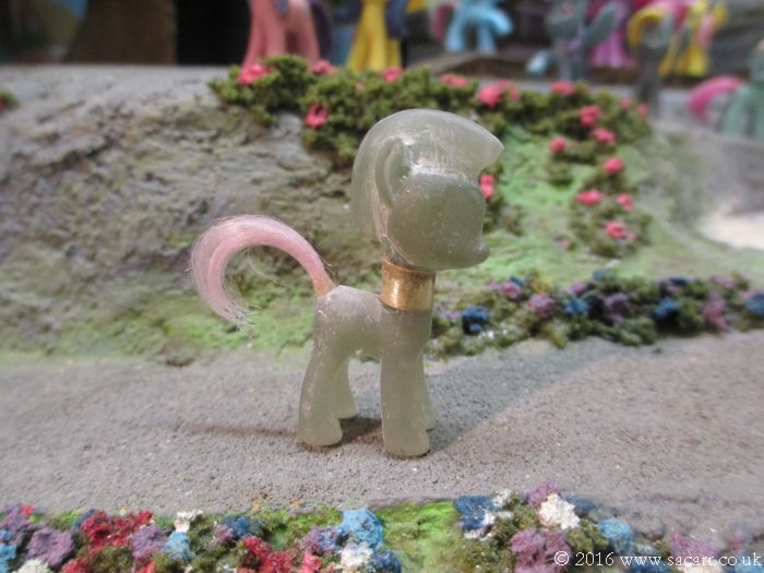

It was hard to see how my remodelling looked when using the translucent green resin. The pony looked ok, but I couldn't be sure, so gave the pony the first grey coat.
Once painted, I spotted straight away an area behind the left ear that needed to be ground away.
After a quick zip around with a dentists burr in the minidril, all looked well again, and that was it for the evening.

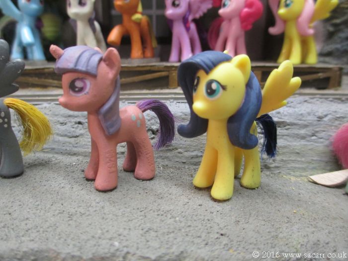

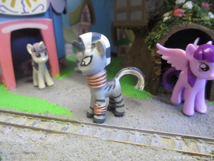

Much of today was spent painting two ponies, a little work on the cottage and photographing the Sun ( astronomy is one of my other hobbies ). Zecora was pretty much finished today with the detail painting done, in several stages, allowing bits to dry and be matt coated so I'd have another bit to hold while painting the rest! All that's left is a little cleaning up of the copper jewellery.

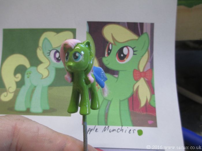

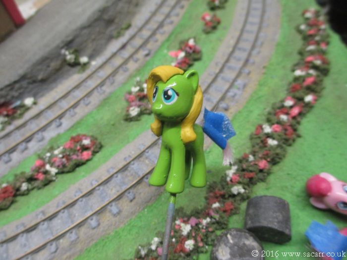

Two of the original plastic ponies remain, a "Pinkie Pie" to make "Miss Cheerilee", but I need to buy some paint for that, as I can't mix the shade with what I have. The other was a "Fluttershy" who's hair was restyled a bit and she became "Apple Munchies".
Her tail was painted a little after this picture, and she was then left to fully harden before any other work.

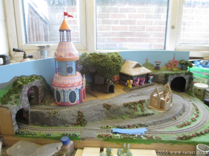

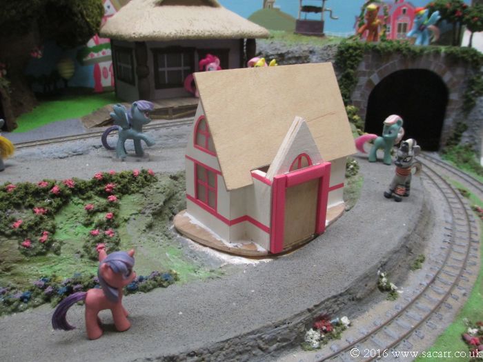

The cottage was painted, the windows had their frames added and were then glued into the building. The first part of the roof was added too, and that's as far as that got.
