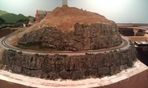

Great looking stuff. Kevin, I love the parking lot and the tree definitely needs to stay "dead" Here is some progress on the shore of Lake Champlain. The rock is finally done after a few weeks of mold pouring and plaster carving. Hope to actually pour the lake this week and get the top of the mountain covered in trees.
Trees or not that looks good.
