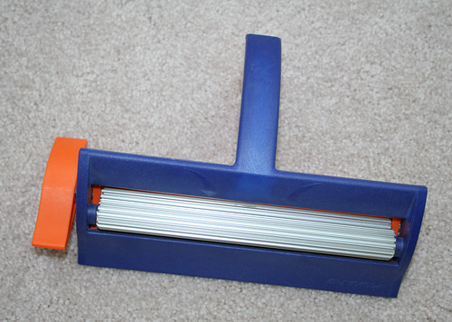

I built a shed in 1:24. At that scale, a paper-crimper made by Fiskars worked perfectly .. and I used cake pan aluminum
While this is twice the size we need for O scale or 4x for HO .. this would work if you could get new gears made. It's only about $14 as Michaels
