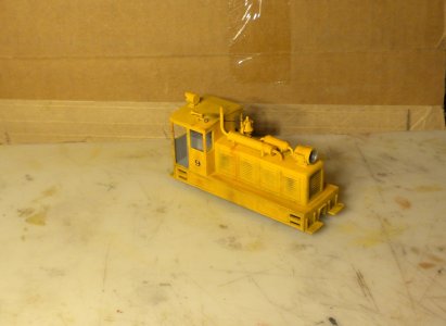

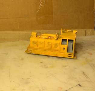

I use PP for about 90% of my structure weathering. I did use them on this scratchbuilt On30 critter project. I sealed it with Testors Dull Coat and it toned down the colors nicely.

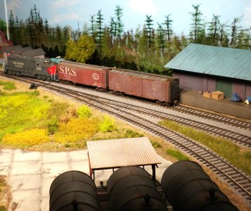

Tom,
Here's a couple of the cars you did in action.
I'm still pondering sending you that GP20. I model the early 1960's and SP put the GP20 into service 1959/1960, so it wouldn't be that road beaten yet. We can discuss it later.
