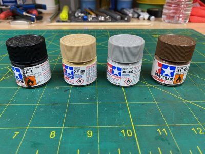

First thing's first, I gave the new loco a coat of Testor's Dullcote.
I started by airbrushing the front and rear intake filter intake grills with the XF-1 and then cleaned the rears up a bit with some IPA, I thought they were maybe a little to dark... I'll touch those up later though. I then did all the panel lines on the long hood sides with Tamiya's Panel Line Paint (black).
I also played around with some 70% IPA and removed some of the ONR logo, I didn't want to go much further with that side, and just left the other side alone. That whitish chalky look from the IPA will disappear with a coat of the Dullcote.
I then next started on roof side of the unit. I applied a light wash with the Nato Black and just straight water applied with a brush, and streaked it downwards on the sloped roof detail on both sides of the cab, I also added some small rust spots with the Burnt Umber on the cab roof and did some rusty panel door hinge and air filter grill effects also on the both long hood sides.
I also did the nose and front pilot, and rear pilot and end panels with the black wash and did the Nato black, and Burnt Umber wash on the pilots.
Next was to give the model another coat of the Dullcote.
For the sides I next mixed up some Tamiya XF-64 to a thin mixture using 50% IPA. I gave both sides of the long hood, trucks and fuel tank a light spray with this.
Next was to shoot the trucks with some XF-80, followed by some XF-64 and some XF-1,lightly to blend it all in together.
Next was to lightly airbrush some diesel soot on the roof and along the long hood top edges and just into the snow shields but no further.
The last thing I airbrushed on was some road spray along the sill edges using some XF-59.
Also added some Black Panel line paint to the hand railing stanchions
I then gave the unit it's last coat of Dullcote.
Last thing to apply was some weathering powders. I generally use these in and around the truck details, steps and walkways and fuel tank. Sometimes I will apply the Black Panel Line paint to the side walkways to simulate spilled engine oil stains as I did here.
Actually the last thing I did was apply a tad of some gloss black enamel below the fuel filler cap, on the tank for spilled fuel.

What are you using for the soot?
Wow, I love it!
Thanks Tom... I used Tamiya XF-1 Flat Black, I'm going to guess at about 30% XF-1 to 70% of 50% IPA.
