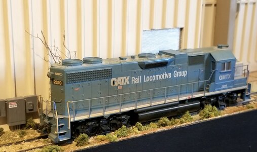

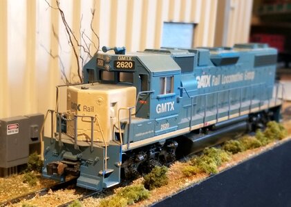

I took this picture last October to use in a For Sale on Facebook. It sold quickly…
