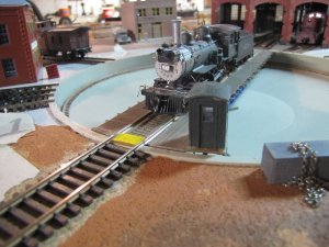

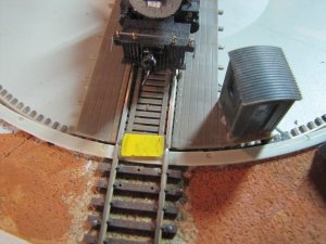

I copied this turntable alignment trick from prototype in Stasburg PA, Pennsylvania railroad museum.
The Walthers 90' turntable kit is not a precise instrument.
Thin plastic cut from blister pack.

I have that turntable Dennis bought it 20 years ago. You're right not best turntable around but affordable at the time. I used a an old decoder to slow the motor down enough to align the tracks. It gets the job done but I like your idea. Much simpler solution. For some reason I moved the operators control shanty to the center.

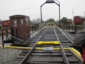

A lot of turntables have those, though some of them are less obvious and not painted bright yellow.
Most real turntables are purely manual, you align the tracks by eye. The locking mechanism does two things. First of all, it makes certain the last little bit of alignment is correct. Secondly, it secures the turntable from moving. A well maintained and balanced turntable will swing pretty easily. Some of them are turned by hand, and it doesn't take much force. If, for some reason, it was to shift as the loco was entering or exiting, it could end up being a derailment. So the little locking dogs keep things from moving.
