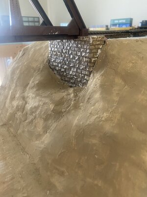

I am seriously considering putting stone walls on the edges of the ramps on the upper level of my layout. I'm figuring some type of random field stone. or random granite stone ,...perhaps like this
Its going to be utilized here,...
Its been suggested I use some flexible stone materials like those produced by Chooch
I would recommend one of the Chooch flexible stone wall sheets. It's thin and easily mounted on 1/8" hobby plywood, or whatever, which solves the issue of taking up too much space. There are several styles and sizes available including cut stone. It's self-adhesive, but a word of caution; the ends curl and are extremely hard to flatten out and you need more glue than the self-adhesive backing to make them fit flat. Glue and clamp the material to the backing surface (plywood in my case) before installing the wall on the layout.

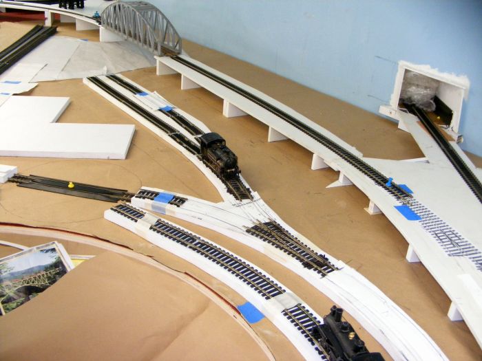

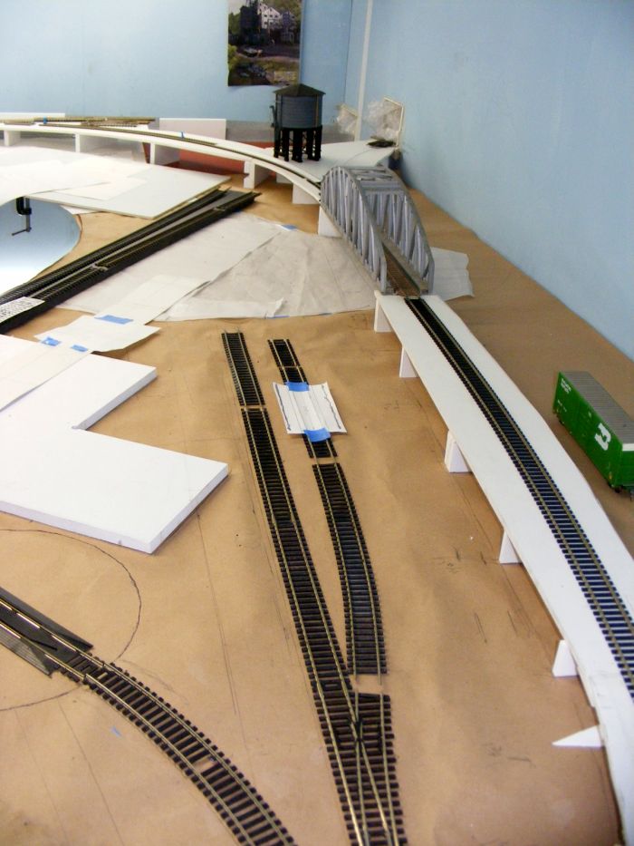

Here is where I am thinking of using some stone wall material,
.........on this ramp of track (behind the cryogenic scene) going up to the coal mine)
...and here on the track going up to the bridge over the logging pond,
So as you can see I may need a fair amount of wall material,...
