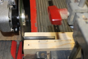

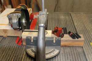

After several posts about using carbon arrow shaft tubing for pipe loads, it is time for me to put up or shut up!
I need to make 75 to 100 cuts so the manual pipe cutter would take too long.
I finally found my 4-1/2 inch angle grinder (Harbor Freight) in it;s box on a top shelf and the 1/16 inch thick grinding wheels.
I cable tied the grinder to a piece of 2" x 10" (with a wood strip nailed to the bottom to fit one groove on my table saw).
This keeps the grinder straight and gives a 90 degree cut. I notched a piece of 1 x 2 block to hold the carbon shaft, marked 10, 15, 20 and 30 HO foot distances and put it on a piece of 2 x 2 to raise the cut height to the middle of the disk. I can cut a piece of shaft in the wood block at a desired length.
Orient the disk rotation downward. DO NOT BREATH THE CARBON DUST, especially if you have breathing problems. This warning is from an arrow technician.
The guide slides the shaft into the disk at the end of the block and gives a quick, clean cut at uniform lengths. I was able to make 13 cuts in under 4 minutes. I can move the cutting setup into position to make cuts in a couple minutes whenever I need to make different length pipes.
