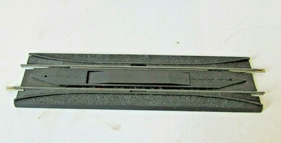

Never really heard what you were looking to achieve, but perhaps this might be another option.
A rerailer that you can place wherever you want. I saw this some time ago, (years,) I don't even remember if it was on a forum, you tube, or where. I don't recall the requirements for length, but mine is 46 scale (HO) feet long tip to tip. It needs to be shorter that the height of the rail, I'm using code 83, this is a piece of .080 styrene, cut to fit between the tie plates, laying flat on the ties.
I cant tell if this is designed only to mate to a stub end track or if it can be used simply setting it over the track (four identical photos don't help). It does also seems to be somewhat warped, but perhaps a heat gun or a hot lamp could soften it enough to straighten that out--wear gloves if you try it.
I cant tell if this is designed only to mate to a stub end track or if it can be used simply setting it over the track (four identical photos don't help). It does also seem to be somewhat warped, but perhaps a heat gun or a hot lamp could soften it enough to straighten that out--wear gloves if you try it.
🤣 That, to me, is a HO scale rerailer, (and it's the angle that makes it look curved). What you don't see are the grooves that run the whole length they just make sure the loco/wagon or coach trucks are correctly positioned on the track without having to bend over and fiddle with the trucks to ensure they are correctly mounted on the track. Here's a better view.
This is similar to the version you guys use, but it's also a tension lock uncoupler, in OO scale.
When I said it seems to have a warp, what I'm referring to is the bottom end of the ramp--it seems to touch the (assumed) table at the closer/front corner, but it seems to be a bit higher up off said table at the back corner than I think it should be, hence the term warp. Might just be my own impression, and "your results by vary," as they say. It's also why I wanted to see something other than the same photo four times--perhaps set in place over a piece of track, for example, with a car on it, etc.

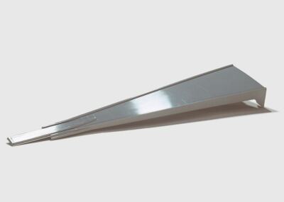

That Hornby does fit over the rails, as I would expect. This one (the one I'm used to, albeit in N scale) was made by Rix Products here in the US: https://www.towerhobbies.com/product/ho-rail-it-rerailer/RIX6280002.html and anyone not familiar with them can see this LIVE ACTION :D photo to get the idea: https://www.amazon.com/Products-RAIL-Locomotive-Placement-6280002/dp/B078VJ7C1M
The Denver N-trak club (DeNtrak) still uses or used them in their staging yards at shows.

I see what you mean, I was using my phone, so that's why I said what I did, so, apologies. I think just the way they've just angled it to take the foto, but yeah it does look warped.
But looking closely at the rear of the rerailer in you OP, there are several, what I can only describe as notches, set into the rear of it which look like they would fit over the track.
The Hornby one's don't sit over the track, it's not separate, it is the track. The second one I posted, the Gaugemaster, which I have, (well, it's exactly the same but from Kato) does sit over the track as the Rix does, but they all do the same job.
I don't have any of the Hornby style rerailers, simply because the Rix or Gaugemaster style rerailers will work on any straight piece of track anywhere on the layout, so I don't see the need.
Ah, no worries. I could have been more clear about looking at it from the bottom end and up the ramp, which I think I typed in and then lost from my last post TOO. Blech!
