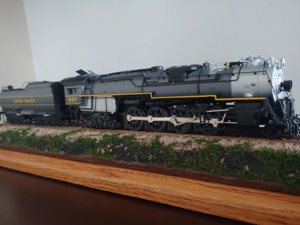

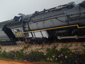

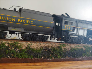

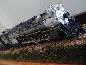

This is a Bachmann 4-8-4 Northern, Union Pacific with an oil tender. This model train is from the 90's. I rebuilt it and added a new drive train that was bundled with a decoder, as a project I took on. I think this decoder is Bachmann's brand, or a low standard SoundTraxx, as you will see in my prior post,

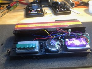

All the newer Bachmann 4-8-4s are the same underneath the shells (in fact you can buy shells from Backmann and swap them out, for example if you wanted a Daylight just order the Daylight shells (loco and tender). What I did was leave the PCB board in place on the locomotive and just trace the wires in the harness to the proper pin out on the new decoder that you will install in the tender. I utilized the Bachmann wiring harness and soldered the leads from the Sountraxx to it. Its actually pretty simple. Here is a pic of the testing stage before I added the second speaker and tidied up the wires a bit.
Great job on your 4-8-4 rebuild by the way. Looks really good.
