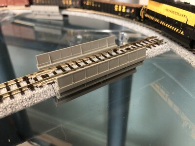

Before I adhere the track to my new micro layout, I want to weather the two small viaducts I have as part of the track plan. Any recommendations on the best method to do this?

These are through girder bridges. A viaduct is suspended roadbed held at grade by a masonry and/or stone arch structure. The girders would be painted black, and over time the fillets, flanges, and rivets would develop rusted sections and streaks below them. The bottom flange would be dirty and heavily rusted.

Ahh okay. I was just going with what it said on the Kato package (2 7/16” straight viaduct).
Good reference pic! Any recommendations for weathering supplies? I was planning on using just black spray paint and weathering with acrylic paints to simulate the rust.

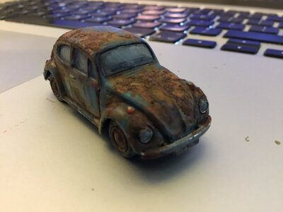

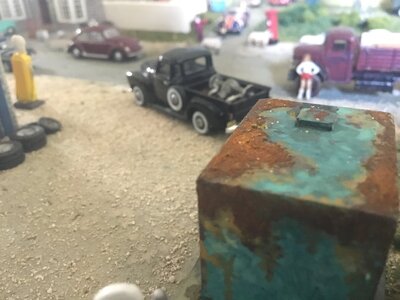

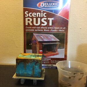

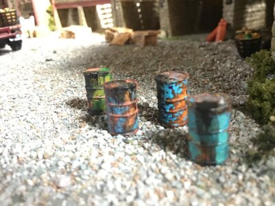

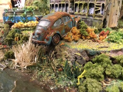

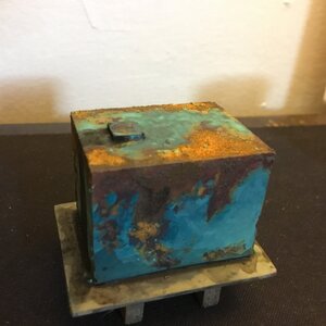

Check out deluxe scenic rust
