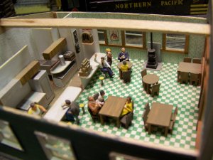

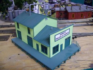

Scratchbuilding really isn't too hard once you get a few under your belt. I was intimidated at first, but now it just seems like second nature. Here are a few pictures which have already been posted here. The first one is a freight station that I built almost 20 years ago. There was nothing on the market at the time that really fit the space I had available so into the pile of wood siding that I had acumulated over the years.
The best advice I could give you is to have patience, and a sharp hobby knife. Most all of my scratchbuilding is for building a structure that will fit into a given space. One nice thing about scratchbuilding is that it seems to be easier to include interior detail of you choose. The freight station was my first building of any size and it was a lot of fun too. Roberts Milling and Cabinets was done completely from Evergreen styrene products. The little cafe started out on an eighht inch piece of tempered masonite. This was the footprint of the building and with the exception of the castings for interior details, everything was scratchbuild, even the windows.
A few inexpensive tools needed will be a steel scale rule and a good sharp hobby knife. A small square would be helpful, but not necessary. You might pick up an inexpensive wood craftsman kit and give it a shot first to get your feet wet. I find scratchbuilding a very enjoyable part of the hobby and am glad that I took the first step.
I am about to start another freight station out of styrene because it has to fit into a rather small space and again there's nothing available in kit form that will work.
