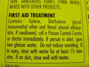

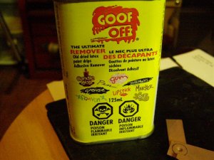

Photos from card number 1 367 (Large) (Large).JPGPhotos from card number 1 366 (Large).JPG
Here's the stuff I use. Looks a bit different than the stuff on the website. Not sure if this is the Pro or the other variety. Judging by the ingredients, I would say it is the Pro stuff. Hasn't hurt any of the seals in my brush, in the 5 or so years I've had it. A small can like this goes a long way. I just put a drop or two on a Q-Tip to clean the parts and spray a few drops through the gun to clean it. Every now and then I disassemble the brush and give it a good cleaning.
