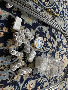

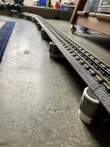

Some people might want to purchase new trestles/pillars to raise your track up off the ground, and that is okay.
However this is an area I decided to be creative and make my own. For months I would find random household objects. Dip tobacco cans, pill bottles, glass candles, etc.
But most recently I wanted to get professional and symmetrical about things. The home improvement store I visited would not cut me 4 inch lengths of any wood, even if I paid for it and I don’t have my own saw. But, I found a plastic tub full of PVC couplers… cylindrical in shape and about 2+ inches tall. I divided them into sets of 3 and packing taped/duck taped them together to make a stable and good-looking trestle system as I show you in photo

Plastic ties, I assume you mean? First time I have ever hears of this.
