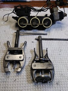

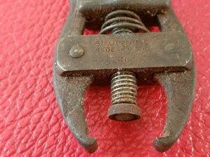

A tool tip from my American Flyer S gauge bench. I have re-purposed the old style battery terminal pullers, ( e-Bay ), for use a wheel pullers for both steamers and diesels.
The center screw has the end bell removed and then the threaded shaft is removed and ground to just smaller than the axle size. The ends of the pullers are ground some what flat to fit behind the wheels. Line it up and tighten the screw slowly. Before and after pictures are below.
Re-installing the wheel is another chat for sure.
