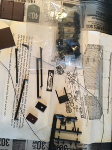

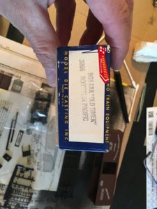

Here is the next project, it is an older Roundhouse kit Old Timer 36' box car.
This is one where they provided thread for the trusses which actually works better than I thought.
1. A couple things I had to deviate was to add a drop of glue under the roof walk at every perpindicular small support to keep the roof walk from being warped.
2. also getting the screws started to make sure they went in before glueing in the trusses
3. I also painted the bottom side first and used an exacto knife to make sure all the holes were open
4. I broke off the pointed end of a toothpick into the first and last holes where the thread was strung, also put a drop of glue at each place. Also used a drop of glue where the thread went over the holders
Here, you can see the parts and simple diagram. Where the directions called for snapping in the parts I glued. The roof line was glued also so it wouldn't separate over time.

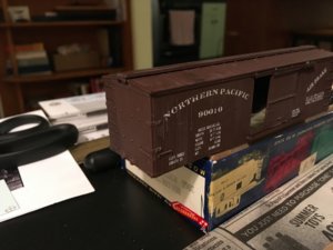

Thank, Yannis, Sherrel, Sweet Chuck-- I got going some more on the new old timer box car, found the #148 Whisker which I forgot all about, much easier to install and they went in easy into this Roundhouse kit,
While waiting for that glue to dry, I got started on weathering the box car. I just used water, about a teaspoon of 70 isopropyl, and a couple drops of india ink and a couple drops of the khaki acrylic paint, put several coats on to get it right.
This shows what it looks like before it dries. The bubbles to away. I had to put some india ink on with a little brush in a couple places because it wasn't doing much otherwise:
Northern Pacific history enthusiast
Here is how the box car shell looked when the paint/wash dried:
The light weathering job shows up best on the roof, otherwise mainly "dulls" and adds some interest to the sides and ends.
You can go over it as many times as you want to get the level that fits your imagination.

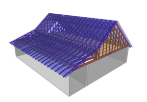

I don't have a track to run trains on, all my stuff is in storage except this window display that I am putting together. I have to work for a couple of more years (I am 61) and we are renting in the cities temporarily while in the process of building our retirement home up in Sandstone, MN.
We have the land and driveway in, as well as the surveying and septic test done so far. Also, we have the house plans roughed in and the windows picked out, also the truss rafters have been designed. The train room will be the entire attic (about 16 w by 42 l usable) as the trusses are of the type where we get a room up there.
I attached the plans. It is really "long term" planning, but that is what we do when we plan retirement, isn't it?

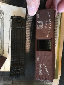

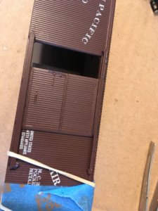

Here is another vintage Roundhouse kit, a 36' old timer NP box car. Much like the C & NW car shown above except this one has movable doors. Same "truss rod" design.
Pretty much everything the same except the flash and molding around the door tracks was not good. One of the tracks actually fell apart when I tried to trim it and had to glue one door permanent. The other door slides, however. Used the same technique (wash) to weather lightly and just about ready to assemble"
1) I put the coat of flat black on the floor and bottom first, , checked holes, glued on truss holders and threaded trusses
2) then put on the doors and roof walk,
3) then washed
